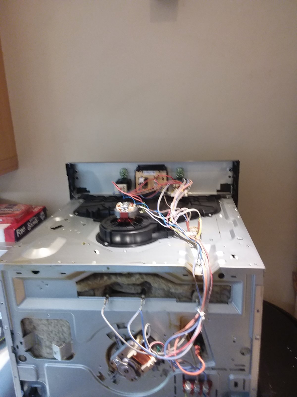

Hello all
My Fan on my Bosch Oven is continuosly on even the have done no cooking since yesterday.
Any ideas?
Bod
Fan and light on only(i.e. no heat at all) is 'defrost mode' on my oven. Could be that?
My Zanussi fan oven has a high limit thermostat which has a constant live feed.....when this stat fails, the fan runs constantly despite the main selector switch being off. Maybe worth investigating with a multimeter.
John :)

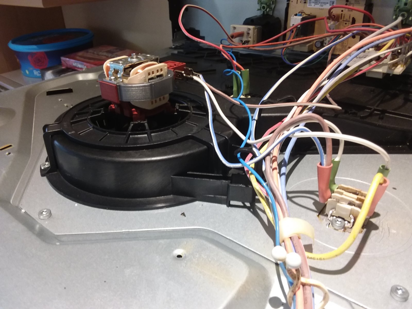

I think I've found the problem.
This is the fan at the top of the oven that is continusly on.
To the right of this is what I think is a switch.
Grease from the hob has got in and amougst this piece forming a continuity between the white cables with a green sleeve.
If I remove one of the white cables, the fan will stop.
So if I hit a new fitting that I think is a switch could this fix 15459190597021727998795.jpg my problem
