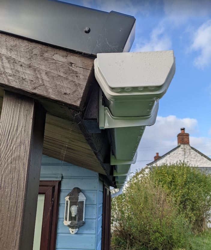

Original Poster here. An old thread I know, but I thought I would come back and show what I did.
Although more fiddly, I opted in the end to make shims - lots of them - to bring the gutter horizontal, compensating for the facia board being off-vertical. The angle needed was about 18 degrees. I had some offcuts of fence posts that are made from recycled plastic (but made to look like wood). I made shims from this using a chop saw. By sheer luck, the dark brown of these matched *exactly* with the facia boards, which are already painted with Cuprinol Shades "Seasoned Oak". You really cannot see the difference. A lucky break there.
Photo below. I appreciate all the suggestions given.
You mde the right decision, I hadn't quite realised the angle - you gutter would not have worked well at such an angle.
Excellent solution - I did the same with timber, planing a long edge to the correct angle then cutting into small sections. Drilling a hoie for the screw through the gutter and before fitting, soaking for days in a preservative.
