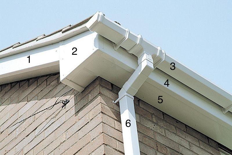

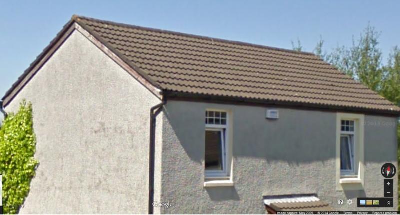

Hi Guys. I want to convert my house from a plain fascia around the bottom of my roof to have a soffit. The main reason is my house sits in a dark corner of a culdesac and I want to have the down lights on the soffits. The first picture is of my roof now and the second is what I am looking for.
IS THIS A BIG JOB??

Yes its a big job, the rafters would need extended, another course of tiles added, not to mention the verges.
A lot of money for a few downlights imo.

Ive been installing fascias and soffits for over 15 years and can only agree with the other commenters here.
You are looking at scaffold all round the house, all edging tiles off, felt trimmed back, timbers removed/cut.
Lots of new timberwork, new felt, new roofline boards, additional row/course of tiles.
It's gonna be quite a big job and you won't get much for your money; an extended overhang at the eaves for your downlighters but as far as I can see there won't be any other benefits, appearance of the house won't be improved much and it won't affect the value of the property...
Unless you have just won the lottery and are looking to waste money I would suggest looking at other lighting arrangements! What you suggested is doable but it's not a 5minute job that's for sure.
