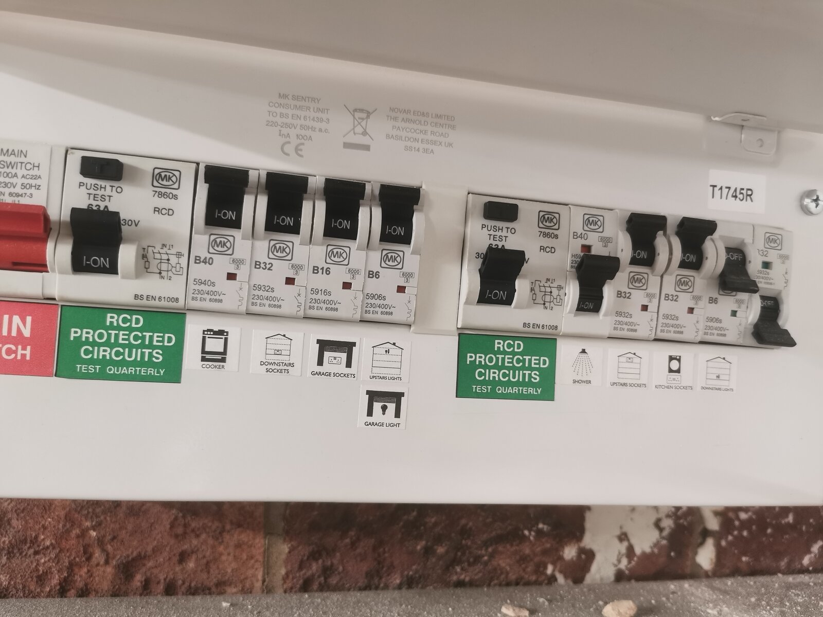

Hi all,
I got up in the middle of the night and noticed the downstairs lights weren't working, looked in the consumer unit and found the mcb tripped.
Flicked it back on and the lights resumed working.
Got up this morning and the mcb had tripped again, put it back on, went round all the rooms checking there were no blown bulbs which there isn't.
Mcb tripped again at some point during the day and now will only stay in for about 20 seconds before tripping again.
Only thing that's changed is the cat managed to get himself shut in the new extension overnight and I've known him to crawl all the way under the flooring to the eaves the other side of the house so it's possible he's disturbed something or wee'd somewhere he shouldn't of.
I'm off on Wednesday and the house will be empty so need to use the time to fault find the issue and could do with some advice re. my thoughts on how to proceed.
Tools wise I have a standard fluke multimeter and a uni-t multi tester that I've rarely used.
All the downstairs lights are wired via junction boxes for each light so, the radial feed comes from the consumer unit in to the first junction box, there is then a cable from the jb to the switch, a cable to the light and a 4th cable feeding the next light on the radial, all the other lights carry on in similar fashion.
There are no outside lights on the circuit or reason to think water ingress is the cause, unless it's the cat as above.

Yes definately a 6a mcb, 2nd from the right.

If every light on the circuit is switched off ,does MCB still trip ? If so ,there is either a short circuit or the MCB has gone faulty ( less likely but possible)
Yes all the lights are currently off and it still trips.
I might, given the ease of doing so swap the 2 6a mcb for the lighting circuits over in the c/u and see what happens, certainly an easier start than going around all the j/b's and it turning out to be a faulty mcb.
