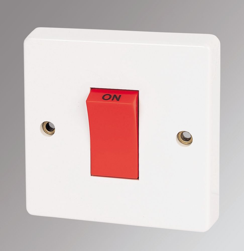

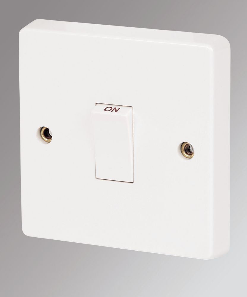

Sorry will post a photo when back at the house but “Taylor” you are right - they are four FCUs not sockets
Three look identical to your photo and are allocated to appliances already (they wrote on the cover). The fourth one says “spare” on the cover so I want to use this for a microwave. However, compared to the photo about this one does not have the “fuse” to the left of the switch, it only has the switch.
Can I go ahead and wire into it anyway ?

Very likely an isolator switch, which are often rated at 45A or 20A, and that is the current rating of the switch/isolator, not a fuse rating, as they are unfused at the accessory but fused at the distribution board. So if your microwave has a 13A plug and there is a standard 13A socket outlet to plug it into. Then very likely the answer would be yes.
