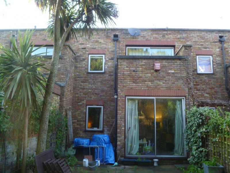

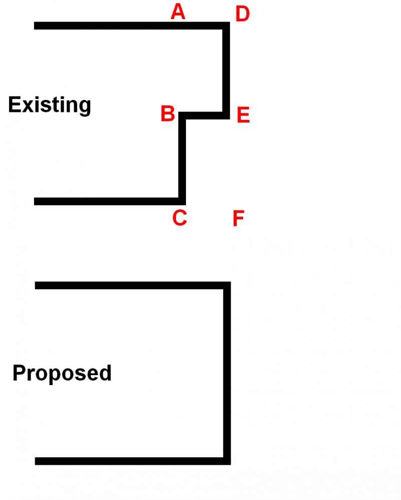

The back of our (mid terrace) house is stepped - I would like to square off the ground floor and install a single window/door across the back of the house. I attach a couple of pictures - one crude plan and an actual photo of the rear of the house.
The first floor has a brick walled balcony above the part of the ground floor that sticks out. I am guessing that I will need three steels put in - one between point A & C, one between D & F and a small one bridging B & E. I assume I already have a lintel/steel between points A & B in both the ground floor and first floor ceilings.
I have seen that prior to inserting steels, walls are propped up with smaller steels inserted above and perpendicular the proposed location of the new steel. My concern is that this cannot happen across the whole wall as the balcony is in the way. However, I'm hoping that as there is a large window in front of the balcony that there isn't much propping up needed in this area.

That can be propped no problem. Your quotes will just reflect the amount of messing about for the builder
Thanks Woody - you have put my mind at ease.

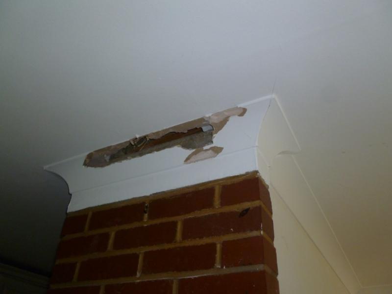

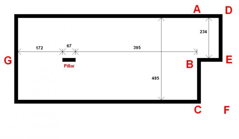

A further complication has reared its head. I knocked off a bit of coving to see if an ugly brick pillar in the room was holding up the floor joists only to discover that there's an existing steel between points B & G in my revised plan(below). The floor joists run perpendicular to the steel and are notched into it (if that makes sense).
How feasible is it to put a steel between points A & C and join it to the existing one between B & G? I fear that my plan of a "simple" extension is out of the window!

Thank you for the reply. I have made some measurements (in cm on the drawing) and done some more digging about and have determined the following:
- Between points D&E (above the patio doors) I have a lintel.
- There is no structural support between points A&B
- There is a steel beam that runs between points G&B which is supported by a brick pillar.
I was hoping the brick pillar could be removed to open the kitchen up but I think it'll have to stay.
I am hoping that a steel can be inserted between points A&C - I realise that this will have to sit underneath the existing steel which will means the ceiling will be lower at that end of the room. Is it acceptable to have a steel resting on another steel?
I am hoping that a steel can be inserted between points D&F - is it acceptable to have the steel underneath the existing lintel?
The only thing that needs supporting now is the balcony wall between points B&E - I'm hoping a small steel can be used that fixes onto the other two steels.
I would be grateful if my thoughts could be confirmed or otherwise. If this plan is acceptable I will go ahead and get the drawings prepared. I just don't want to throw money at drawings if it turns out that they can't even be executed.

Sounds OK in theory but as mentioned there may be posts required or masonry nibs at the ends of the new steels. Your SE will determine all that.
What does the steel between G&B actually support?
It may be possible to get the steel between A-C to sit level with the steel on G-B, just needs propping and connecting on site.
Just outline your optimum set-up to whoever you employ.
I am wondering what the steel from b to g supports. I would suggest that it is to support chimney breasts upstairs. If so it may be possible(but by no means certain) that the upstairs breasts and chimney stacks could be removed thus negating the steel. Or, if the room is as open plan as it looks the steel would be replacing the spine wall and thus cannot be lost.
Thank you both. The steel between B&G supports the floor joints for the first floor. There are no chimney breasts (property was built in 1985). The joists run perpendicular to the steel and are notched into it - I guess it replaces a spine wall. I am of the opinion that it cannot be removed.
Alsdo, thank you for confirming that the B-G steel could be connected to the A-C steel. This would be my optimum solution and I will talk to the SE to see if it is possible.
