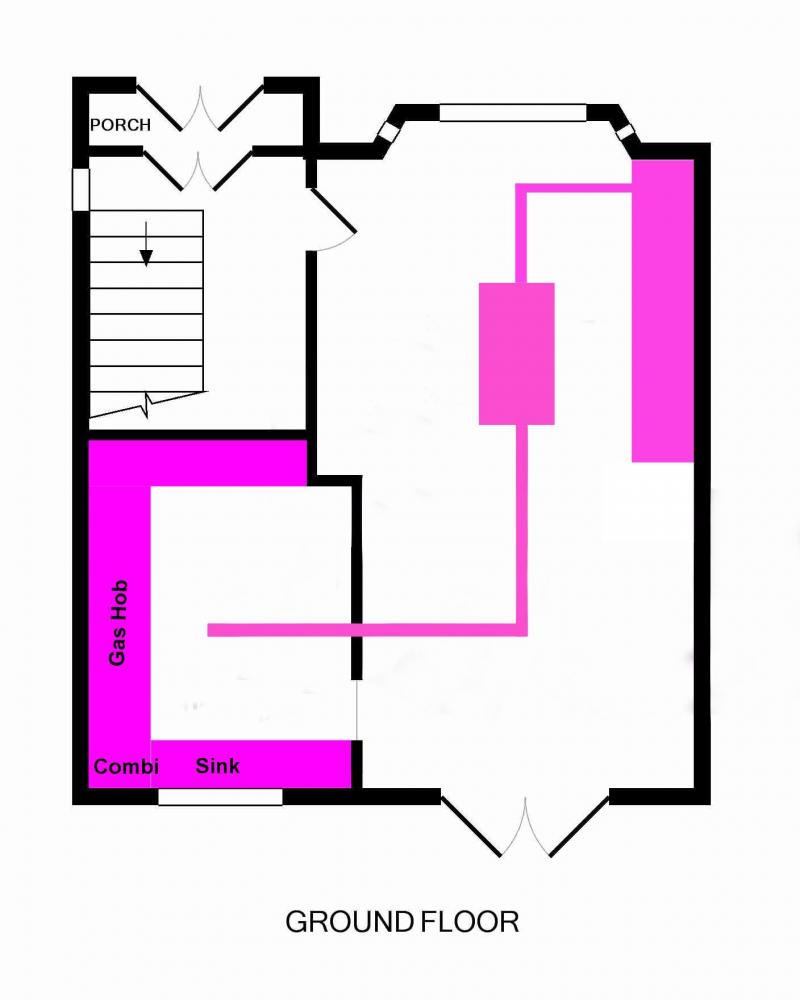

I'm hoping to buy this property. I've now go this idea of moving the kitchen to the front of the house so that I can knock down the partition (see picture) and have an open living room looking into the garden.
Unfortunately I start to realise that it might be just a dream when I consider the costs and practicalities. I'm not concerned about the installing the kitchen units and taking down the partition. The issue is the plumbing.
I'm assuming the biggest challenge would be to relocate the combi in which case and to keep the costs down, I can leave it since it's tucked into the corner anyway. This leaves the gas, water and drainage pipes. The floor is concrete. Is it a case of chasing one big channel for all the pipes? I know it's not as simple as running them under floorboards especially after reading about the corrosion of copper pipes when in contact with concrete.
I really got excited about this idea as it's something I've always wanted and I know I can do a lot of it myself but when it comes to plumbing, I prefer to leave it to the pros but if this plumbing is going to cost me a fortune then my idea is scuppered.
Is it just a case of deciding where the gas hob, oven and sink will go then making a big fat channel along the floor? How much extra would it cost to move the combi?
If you can help me with any ideas and costs I would really appreciate it.
It's pointless asking for costs.
But your biggest hurdle will be drainage.
Which you haven't marked on the drawing.
Judging from your post, I now know that it's probably not possible but:
Why can't the drain/soil pipe follow the rest of the pipes back to the original point?
Thanks for your help.
Because you need a 1:40 fall. Making it likely to be uneconomical depending on the depth of the termination point that far away.

Without knowing more about the building, I would say that it is likely that you will need an RSJ or other structural aid if you want to remove the partition as it is probably supporting the floor above.
The only drainage close would be the down pipe for the gutter next to the front window which I share with the neighbour. Do regulations permit that or is it not practical anyway?
Is it a case of finding out where the drains are located outside and even then does it have to be a certain drain?
Rainwater is usually a separate system. Even if not, there is rather more involved than just shoving a new pipe in there.
Yes, it must be the correct one, additional underground drains will almost certainly be required, and all of it must be installed properly.
The work you propose also requires building control notification.
Given the issues already involved, a sink on an island unit won't make much difference - it's likely to be expensive and difficult either way.

We moved our bathroom from the back to the front of the house. Initially every plumber we asked for a quote said either it couldn't be done or would be ridiculously expensive. Then I got the Building Reg's bloke to com and see what we need. He then liaised with a draftsman to draw up plans for building regs, total cost £150 + the building permission fees.
Job all done for less than £1000 not including fittings.
So try asking your local Building Inspector for his opinion, after all asking cost nothing.
