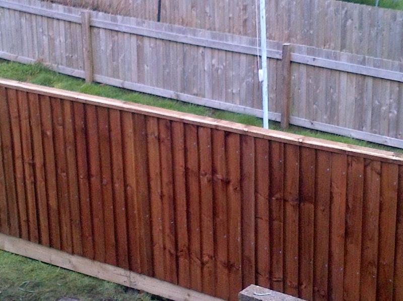

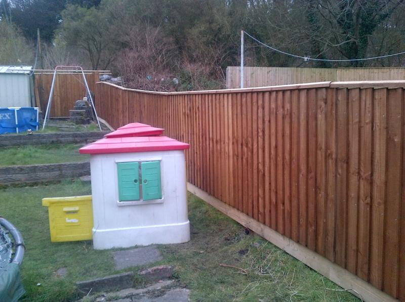

Feather edge fence 1st time
Nice - but it is normally accepted that the fair face would be presented to the neighbour's garden, rather than your's. No rules about it, but that would be the norm.
excellent really neat job bet your pleased with the results
i do hope you have "pinched" the adjacent board to avoid splitting
in other words you have a nail in one edge and the other is pinched behind the edge off the next board allowing movement so only one nail hole across the width
when i asked the people who supplied the fencing they told me to nail through the board so that the nail goes into the thin part of the one behind.
in other words 1 nail through 2 boards
thats what i done :?:
as it expands and contracts you will get splits around the nails
have a look at fences you pas and see if they are overlap or nail through both and look to see which slats crack and split

its not hard, it can be hard work but im a big bloke, my ground was good too.
worked out about £20 per metre, about £500, could have done it for about £420 if i looked about a bit more.
all i can say is don't do it cheap with cheap panels as that will be false economy.
in my picture i used 4" x 4" posts, dont use 3" x 3"
watch videos on youtube, pick a design you like
i ran a string the full length of the garden so the panels were straight (i did cock one of the posts up and it did put the fence out slightly)
I made quite a few mistakes, but only i know ;)
will keep a check on them, nothing i can do now, i just went what the guy told me in the fence place. :)
its not a criticism in the least
you've put your heart and soul into it and you have done an excellent job that anyone would be proud off
generally you don't point out things when its to late as it can be seen as unesisery comments but because a thread will be read by many tens if not thousands off people its worth mentioning at risk off seeming "unfriendly" :D
Yeah I know, would rather help others like you mention. :D

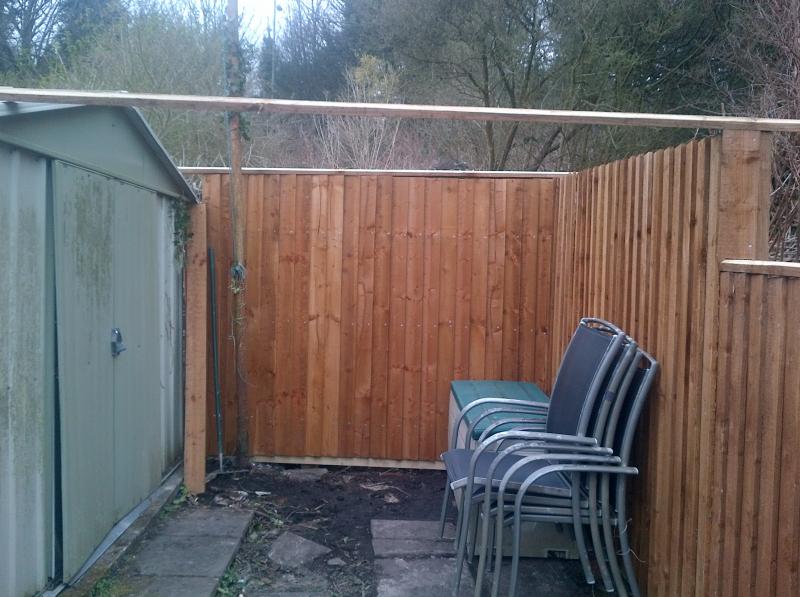

I appreciate this is old but interested to see wht posts you used?
I'm doing similar but think I cocked up using 3 x 3 and only gone 500 deep?
