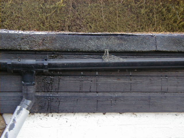

I have a couple of longish cracks right on the edge of the felt garage roof. (I suspect damage caused by gardener cutting back over-hanging bushes - another story!).
would I be able to seal the cracks with Acrypol?

Thanks both.
Rest of the roof is fine. No obvious cracks and no internal drips or damp.
Just that one edge. Certainly not keen to re-felt the entire double garage roof....!
Rather than buy a big roll of something just for a small piece, have a look at some of those aluminium or SS mesh products often sold for plaster or render patch repairs
Yes that's the stuff go for the lighter 450g grade
Wire brush the area clean first ,then spread acropol over the area you need repairing. Cut a patch and lay it over the area you have painted and then dab & paint over until the fibre glass has gone. It generally comes grey as standard but you can get it in black as well. And even white for that matter.

If you do use acrypol you can get acrypol scrim membrane to use with it.
The scrim stops the acrypol paint from cracking open.
