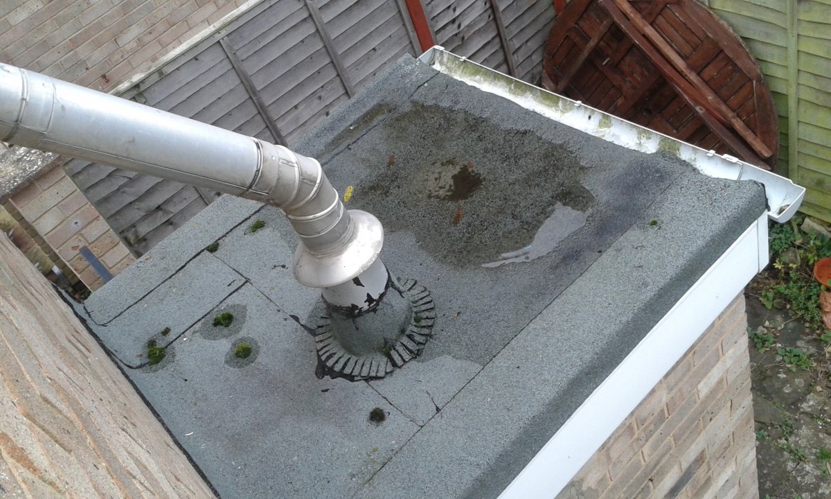

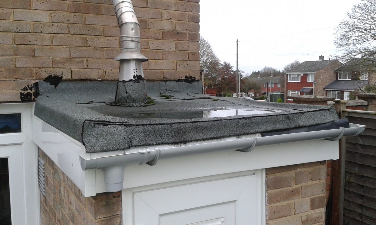

Hi,
My boiler roof is leaking and the felt roof is sinking (I have attached a picture & links below) . I would like to diy however before i start on the project, i would appreciate if anyone could advice. Should i remove the felt roof and replace it or paint a sealant on it? I have a very minimum budget on it.

I think you'll find the original timber underneath the felt is in poor condition now......I'd seriously consider its replacement if you can possibly do so.
If you can't, then coat it with MKM's Evercryl for a good if not permanent repair.

Given the damage below the surface coverings not much will last for long - smearing liquid bitumen everywhere might get you thro the winter?
The leak is probably starting thro the "fingers" of felt flashing at the flue. That kind of collar is for a hot mopped roof.
Remove the roof entirely. Replace with a roof to falls.
Re-assemble the - is it a mix of single wall & double wall - metal flue which seems to have been installed back to front. Perhaps, attempt to re-route the flue.
A GSI should have a look at this set-up from boiler to terminal?
The RWP is missing.

The odds are that fungal damage has started inside the roof - leave it and next comes dry rot.
Given such delapidation i should suspect that the boiler is inefficient and possibly badly installed. Experience indicates that such neglect will possibly be general.

If you have a gas boiler GoodOne, do contact a gas safe engineer who will advise you on the flue requirements for that particular appliance and also the necessary terminal to take it through the roof. He will also advise if the ventilation is adequate.
The roof is a complete mess, I think you'll appreciate and its time for it to go. A popular method these days is a glass fibre replacement which is laid up, on site, in one piece.....the timber beneath is sure to be in poor condition, I'll wager.
In the meantime, can you replace your missing rain water down comer, and direct the water into a suitable drain?
John :)
Good man.....if you can't afford to do your roof now, my Evercryl recommended compound - which is glass fibre reinforced - is a get-you-through-winter possibility. MKM sell it, pricey for what it is but it does work.
