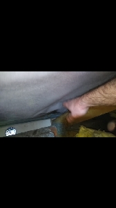

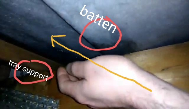

Hi everyone. I have a question. I had recently roof felt trays done. I'm worried that last batten supporting the tray has been put not in line with others a bit higher to pass the facial. What do you think. Will I have a big issue there ? thanks

Its not clear to me what your pics are showing?
Do you still have the scaff in position?
Have you looked at any of the videos ref installing retro Eaves Support Trays - much depends on the roof pitch, and the height of the fascia, and the fixing positions of the last battens.
The felt should come down without any dips, cross over the tray and fascia and peep into the gutter.
Explain what you mean by drips.

Posting more photos where the yellow arrow points felt is going a bit uphill because the batten supporting the tray
