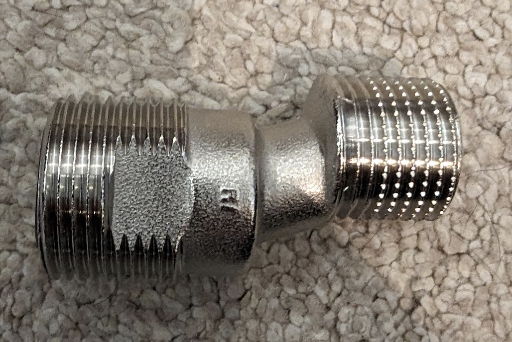

Our old shower mixer has started leaking, so purchased a new Grohe shower. To fix the mixer bar however, you're provided with the adapter below. Looking online, the instructions basically come down to "screwing it into the wall connector." The "issue" here though, is that my shower pipes are just that, a 15mm copper pipe with an olive stuck on it from the old mixer bar.
Does anyone know what type of connection I need to screw this into? I'm assuming i'm going to have to cut a bigger hole out of the tile somehow, and fit some sort of female compression fitting onto the pipe so that it then sits flush with the wall?
The online instructions go about as far as showing me this, but I have no clue what these are, or how I'm supposed to fit them in a tiled bathroom

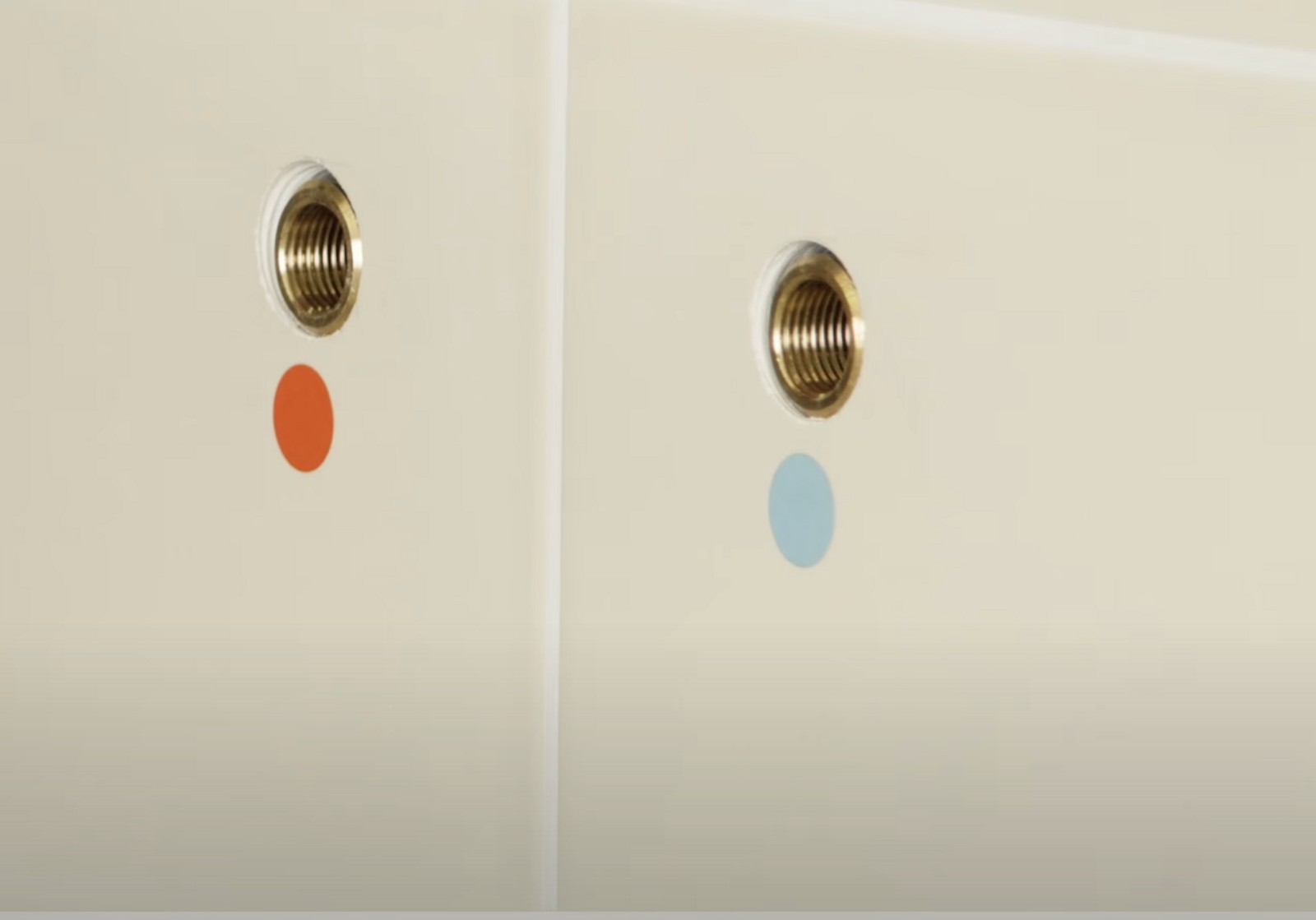

Show us the current fixings.
The connections you have been supplied with are Z connectors, they allow for a certain amount of 'flexibility when it comes to pipe centres but need female connectors (end plate), securely fixed inside the wall

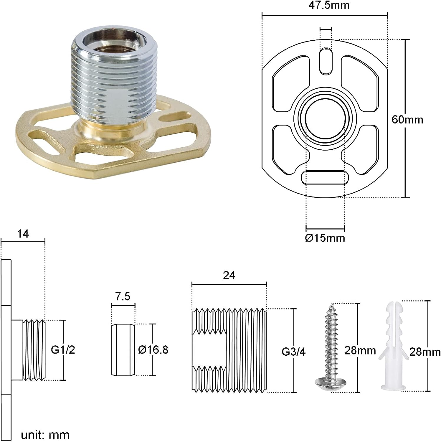

A better solution and more common now are are usually these fitting kits -
or something similar to this

The female ends of the end plates are 1/2"BSP, the smaller end of the Z connectors fit into that, the larger ends are 3/4" BSP and are what the shower connectors fits onto.
Obviously your current pipework isn't suited at the moment, especially if they are already 150mm centres and just pipe tails (Pic would be good)
The fitting kits use a 15mm copper tail (needs a certain length) coming out from the wall, once the brass backing is attached to the wall and the threaded compression fitting end is tightened up (olive in the middle), the larger end is a 3/4" BSP which is what the shower fits onto (once the shroud is fitted).
Whether the ones you have ordered will fit will really be down to how long the '15mm shower pipes' you have sticking out the wall, are just now once you get the olive off of them. As you can see from the tech drawings you'll need at least 22>23mm of clean pipe.
