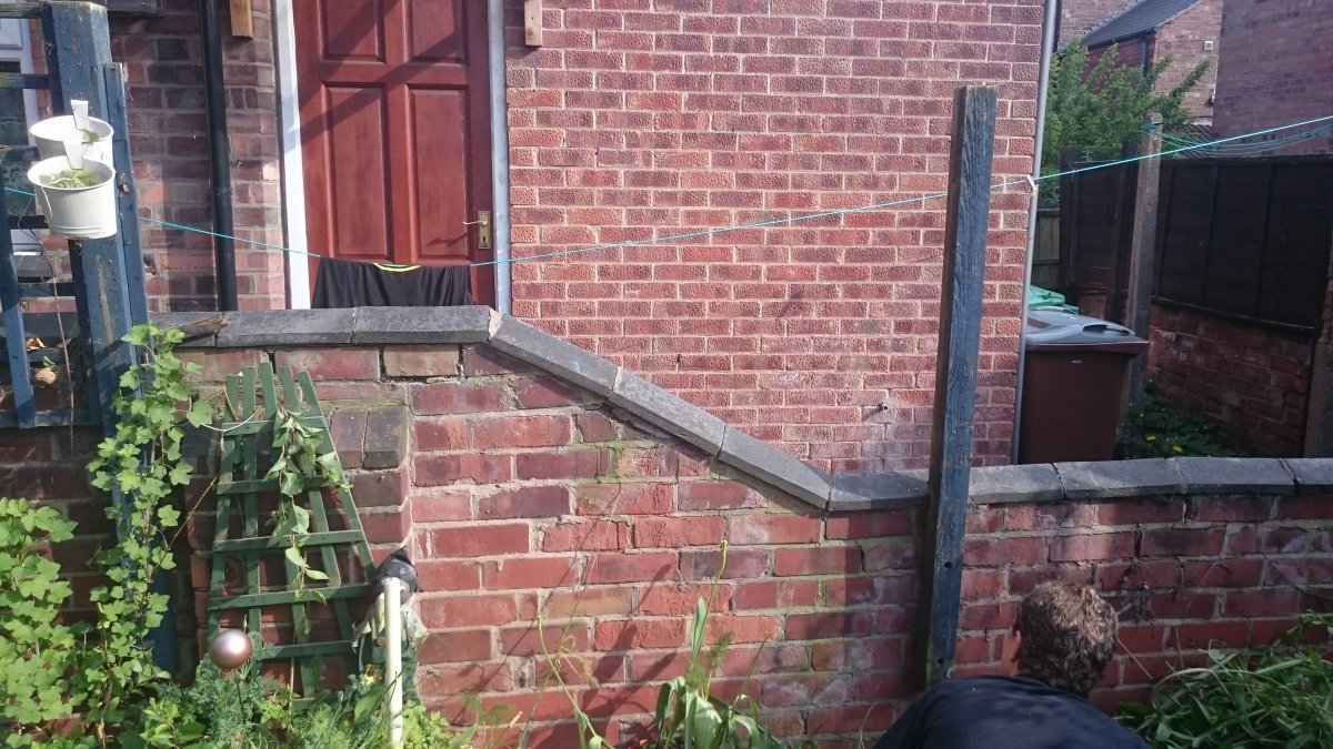

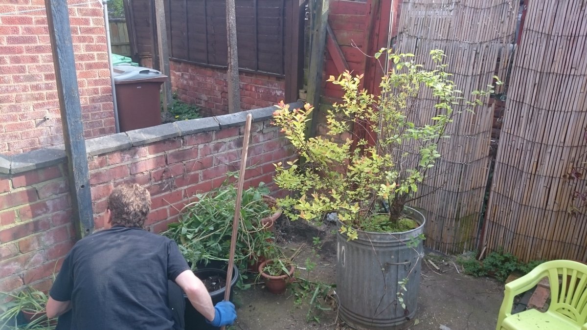

I have lived in a vic terrace house for 8 years but never done much to the back yard. There was some trellis fencing attached to a boundary wall (by posts as there are cap stones) on the left side and so lapboard fencing attached by posts on the right. As the fencing was trellis, we stapled some bamboo screening a few years ago for privacy but its all falling to bits.
Today we have taken the left side down to see what we are working with and the wall doesnt look great. I cant afford to redo the wall at this point.
If we were to attach new fencing to posts bolted to the concrete, how do we get it level as the garden is on a slight slope.

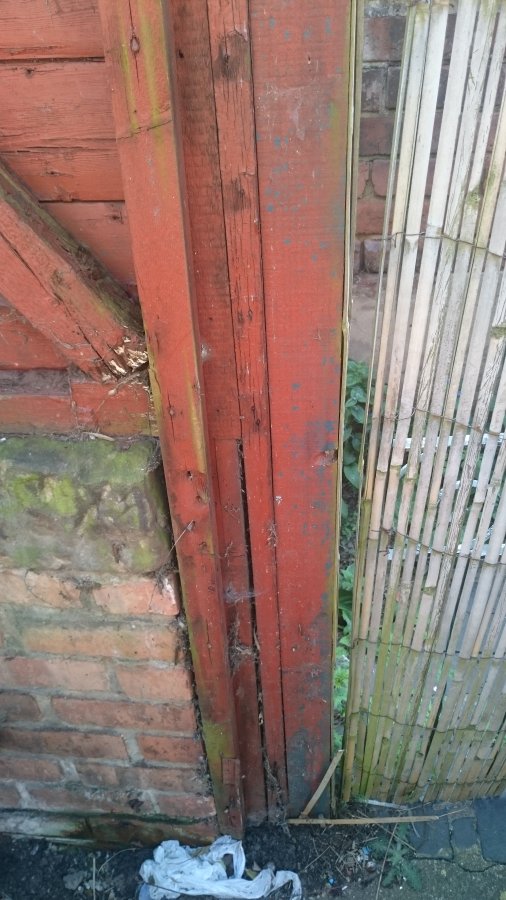

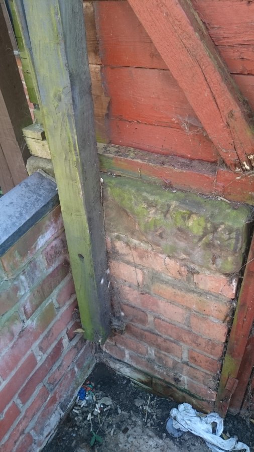

Also, what would be the best plan of action for the corner (pic attached) where they seem to have nailed lots of wood to other bits of wood to fix the current gate. Its all a bit loose!
Thanks muchly!
Carrie
Right I see now - so you're thinking of putting the posts into those square metal sockets that then bolt down to the concrete slab on the ground, in front of the wall and free standing - but the concrete slopes - so just pack under the gap on one side of the plate after you have uprighted the posts - you could either drive some wedges ( hardwood ideally) in and then fill the gap with 2 part resin you can get it in screwfix, (it comes in a tube that goes in a mastic gun they will help you out. ) That will take up the uneven gap under the bolt down socket. You can even mix the resin with some clean sand to bulk it if the gap is quite big. I've done this myself before.
Not so sure about the gate yet......
