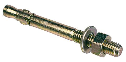

Hello all. Back fence is wobbly (neighbours own). It is just one post that's the culprit and they have all the posts and rails on their side. No matter how many times they've tried to 'fix' it's just not working! I have a few spare posts and I'm wondering how I'd go about stabilising from my side ie; fixing additional post and bolting onto existing post. I know I'd have to concrete post in on my side, but not sure what type of bolt/fixing would do the trick. Every windy day I'm watching and waiting for it to go, so trying to stop it happening and ease my paranoia! Neither of us are in the financial position to hire a tradesman to do the proper job that's needed, so wanting to pick your wise and wonderful brains for a temporary fix to last hopefully a bit longer!

Should have mentioned that its continuous closeboard all the way along, so don't have easy access to the posts their side. Rope would be an ideal easy tether like you say, but wondering if there's any selfscrewing bolts or the like that I could attach from my side.

Then use a concrete repair spur that coach screws to the rotten post through the fence and into the post above ground.
Use a few brick bits to pin the underground spur in place and add one or two postcrete bags and add water.

Amazing. Thank you so much. Coach screws are exactly what I was looking for, just hadn't got a clue as to the name! This sounds like the easiest and best route to go, thankyou for the detailed explanation... now to bribe my 13 year old for his help and brute force
If the existing post is concreted in place then I think that you could attach a bolt down post holder
to it, using concrete screws. Into that you would put a new post and bolt the new post to the existing rotten one.
