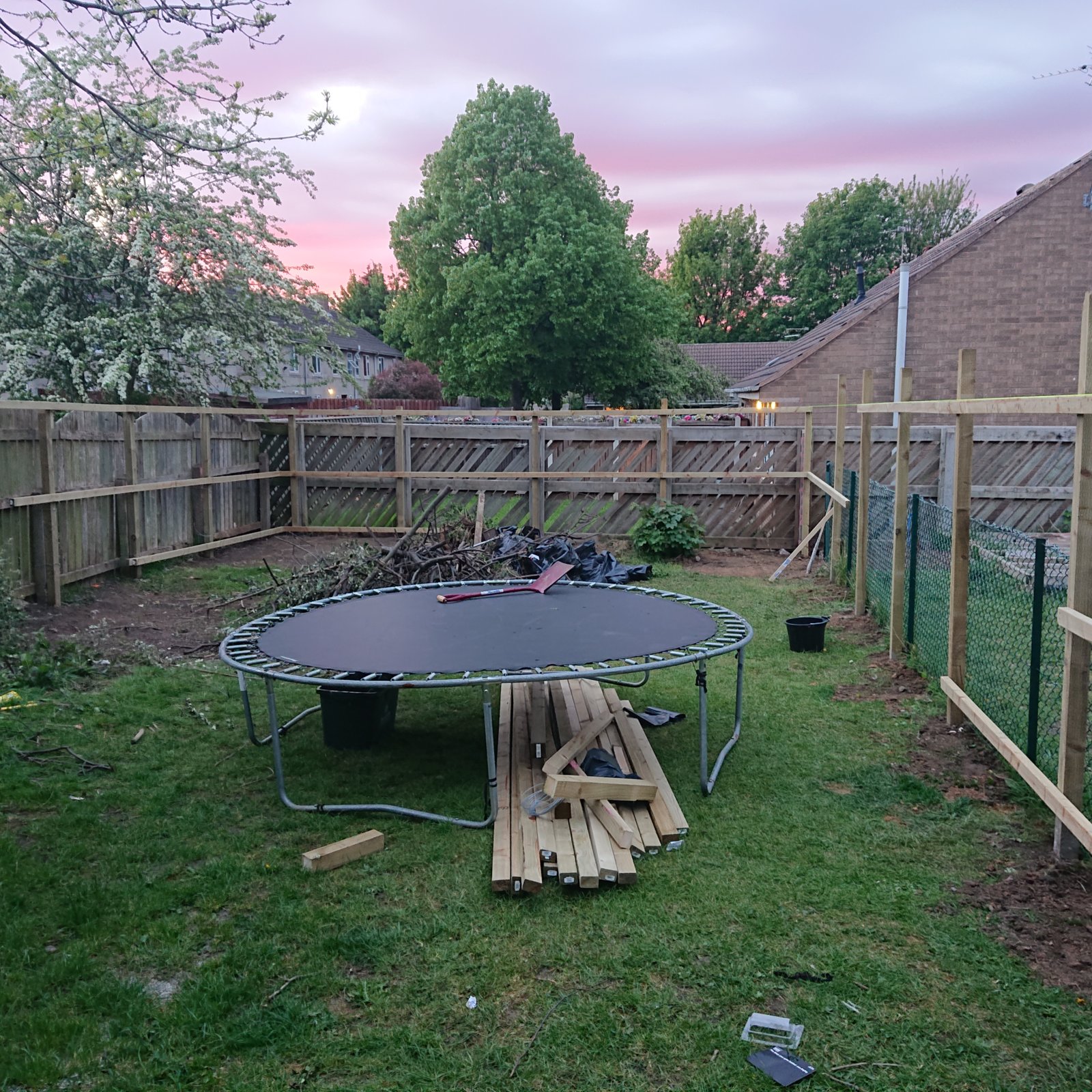

I'm in the process of fitting my first ever fencing and tbh I'm having a mare and now I'm worried I may need to rip out where I am and restart.
Basically I'm self employed and whilst off I started the fence 36m or so around 3 sides
1 side and along back. I've been able to bolt my posts to existing concrete posts, but the longest length, I fitted 3 x 3 posts about 500 deep. Each post set about 1800 apart, and had a bag of Postcrete each to set.
The fencing will have 3 battens along the length and was planning on featherboard.
I dropped a stupid mistake in not setting a string line and went for sighting through, so some slight wave along the length.
I was toying with idea of something like a deck board along top. Into posts and top rail to try and sure it up. But really worried the posts won't withstand a strong winter. I still have some headaches to overcome on the longest length too between ours and the neighbours.
So would appreciate some advice going forward?
Thanks in advance

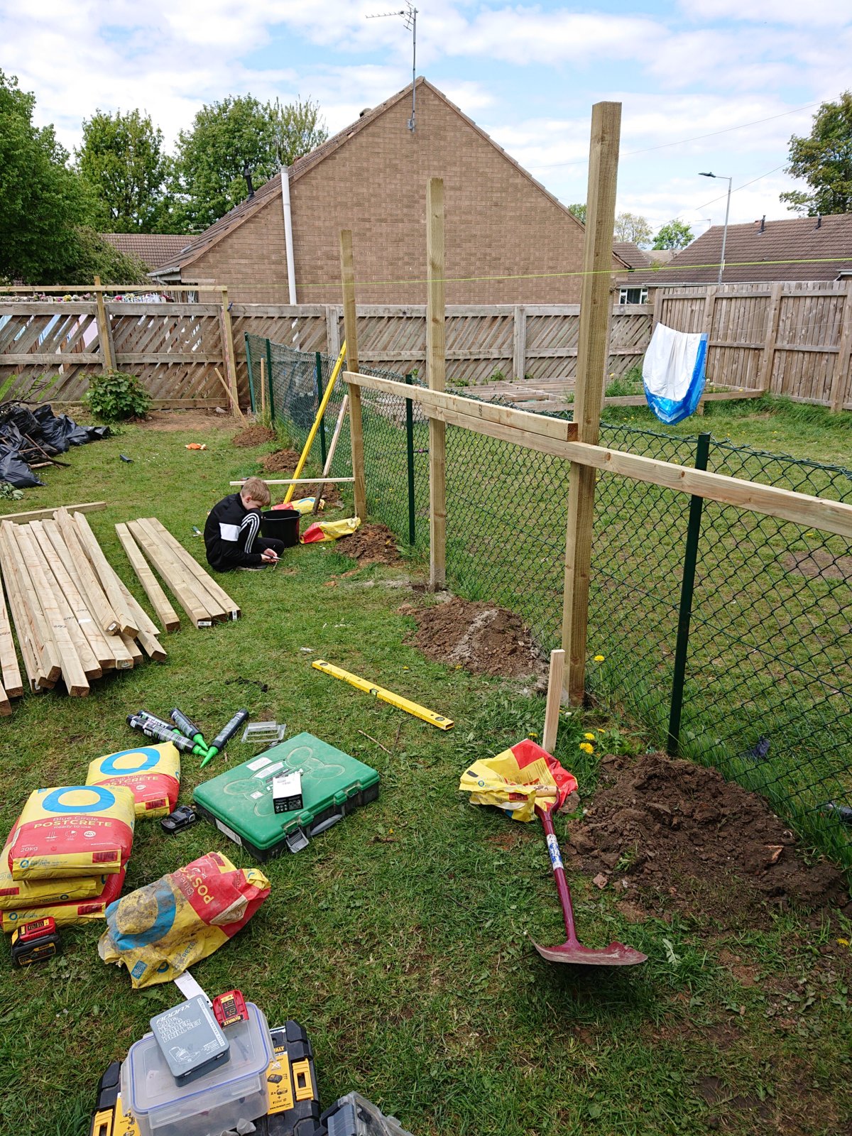

How tall are your finished posts going to be?
Ideally there should be a third of the post in the ground
Planning on 1800. So in theory should have been 600.
I also think the 3 x 3 was a big mistake. Can't say for certain if I got the holes 230 wide as some suggest, and even coverage round all 4 sides as the posts were close to the chainlink fence.
Each post had a full bag of Crete though
Mine, its a council house. I'm a joiner but wanted to challenge myself before ever doing one fir a customer
I'm trying to think if it fails, why, how and can I overcome it to make or right?
Dan.
I would whip them out and start again for a longer lasting fence. I'd say with kids ( kicking ball against them. running and bumping into them ) and the height you want one bag per post won't hold up to much. For a 6ft solid fence i would at least 2ft with a 1ft wide hole. Do your 2 corner posts at the house wall first with the 6ft height and leave to set. Do you 2 corners at the bottom of the garden making sure you have the 6ft height above ground and run string line top and bottom to each post. Put your bottom and top rails on first as you bed in each post.

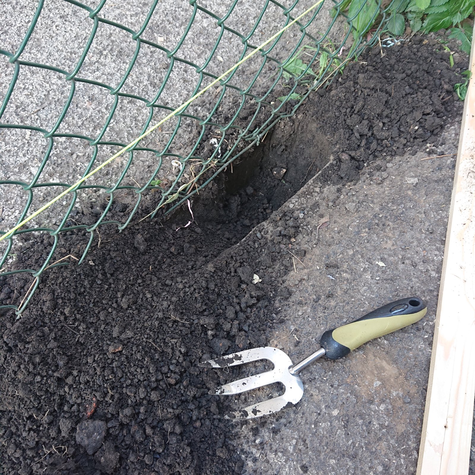

I have this section about 7mtrs the gap is 4in wide 2 solid paths between 2 houses. What's your thoughts on this.
I was thinking dig down 4-500 deep and perhaps 8in either side and sandwich the posts in?

Wish I could but there is a gas pipe under there somewhere.

The post issue with the pipe not worth the risk hammering in. I'd go for the option you said about wedging in. You could sandwich between a dense block each side cemented in. Give all the bottoms of the posts a good soaking with treatment before setting in especially all your end grains.

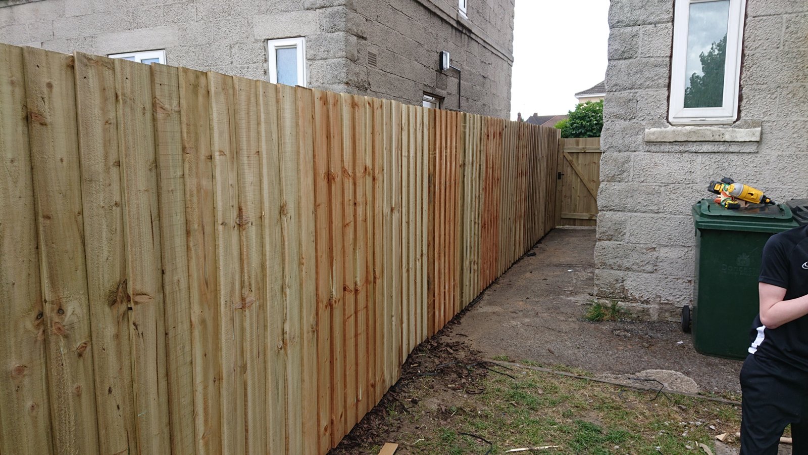

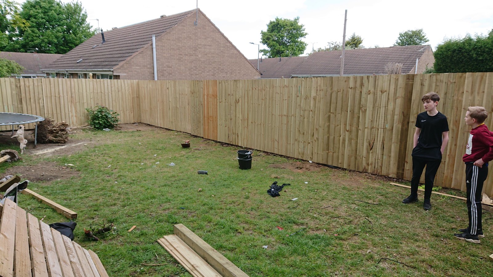

Really well, I pulled out 3in posts and dug a little deeper and put 4in in, 3 bags of postcrete each and finished.
Even the section between the houses that I could only dig down 300mm but wedged in with postcrete

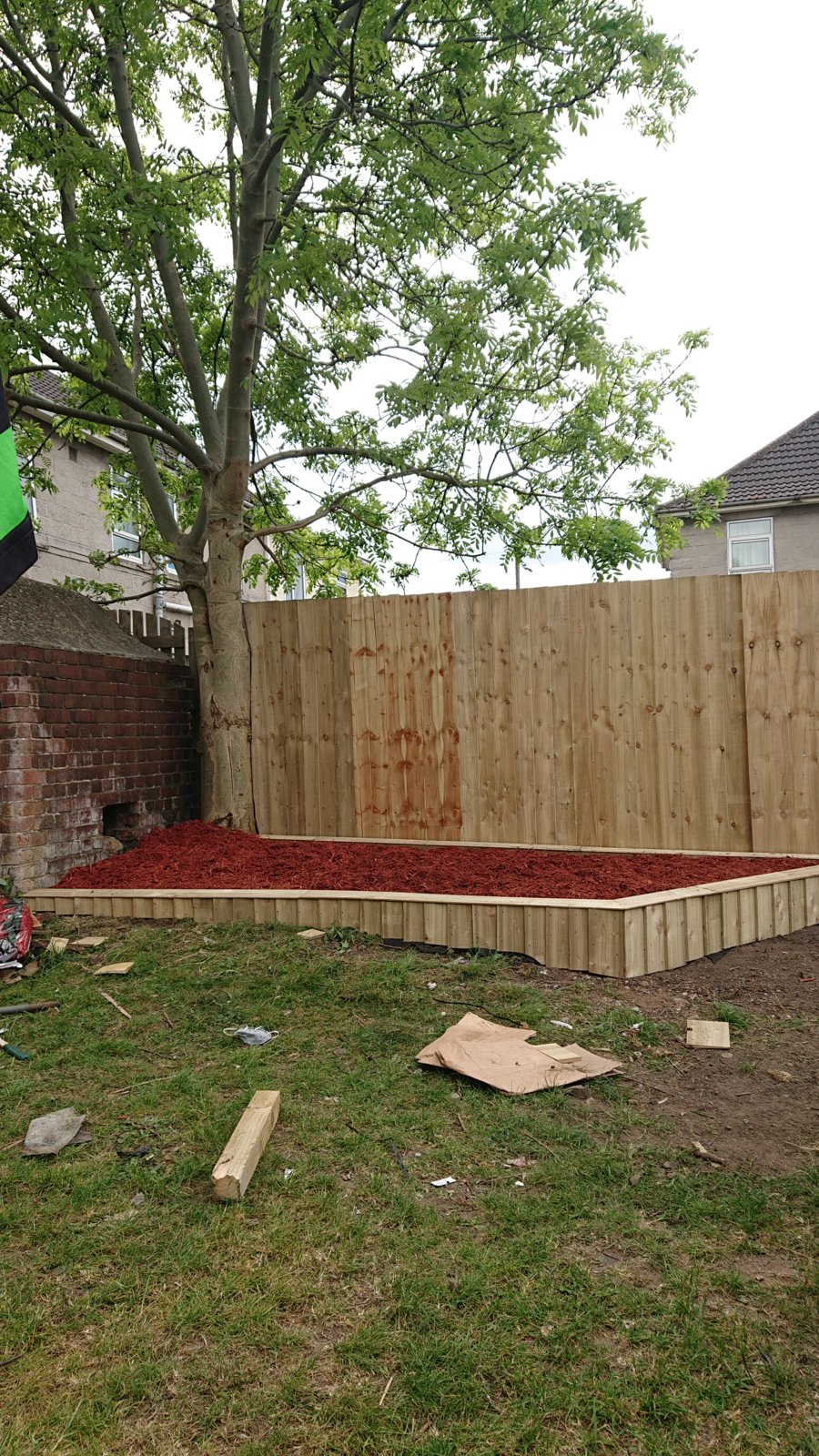

Just finished a 7x3m decking too

Looks great!, after attempting to pull over 40 posts out that were concreted in I went for an alternative method 2nd time round.
To be fair they'd done 13 years.
Looking spot on Dan. Very impressed with the straight line top. Looks like two volunteers for the paint there too lol.
