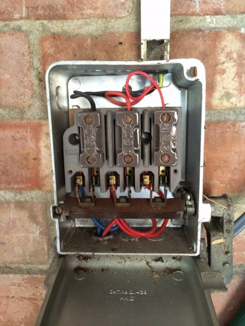

Well silly season finally seems to be coming to an end. Here's some of the things I've seen in my travels all over the country in the last couple of months.

Fused neutral

The terminal blocks were in the same cat2 twin fitting. The heat and direct UV kills them quickly.
The pillar is from a caravan park. It looks to have been replaced with new and bodged well. If you notice, there is a 2.5mm armoured taken directly from the 60amp circuit...
