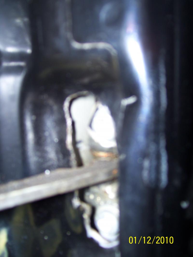

And finally the door hinge has seize up and has broken the metal on the door (where is fastens to), really need a got body work shop, does anyone know any good ones in Cheshire.

on the door problem,is it to do with the door strap,has it pulled itself out from the metal and just floating around?
when this went on mine i used some large penny washers and rebolted the strap back to the metal work,worked perfectly.i think this problem is due to lack of grease in the general area,suggest you grease all the others before they have problems.
im wondering if you have some pipework that has perished for the heater problem hence the squeaking?
all others doors have been greased (y) , the actual metal on the door where it screws to has broke was thinking of making a new plate or something will upload a pic maybe later, when go back outside
Here is the door hinge
Sorry it’s the best pic I could get, but that’s the hinge that gets fastens to the car door, as you can see it’s a bit broke due to the door hinge failing and breaking the metal on the door, the door was also well greased.
Does anyone have any good repair solutions; was thinking replacement piece of metal welded to the door, would it work?
