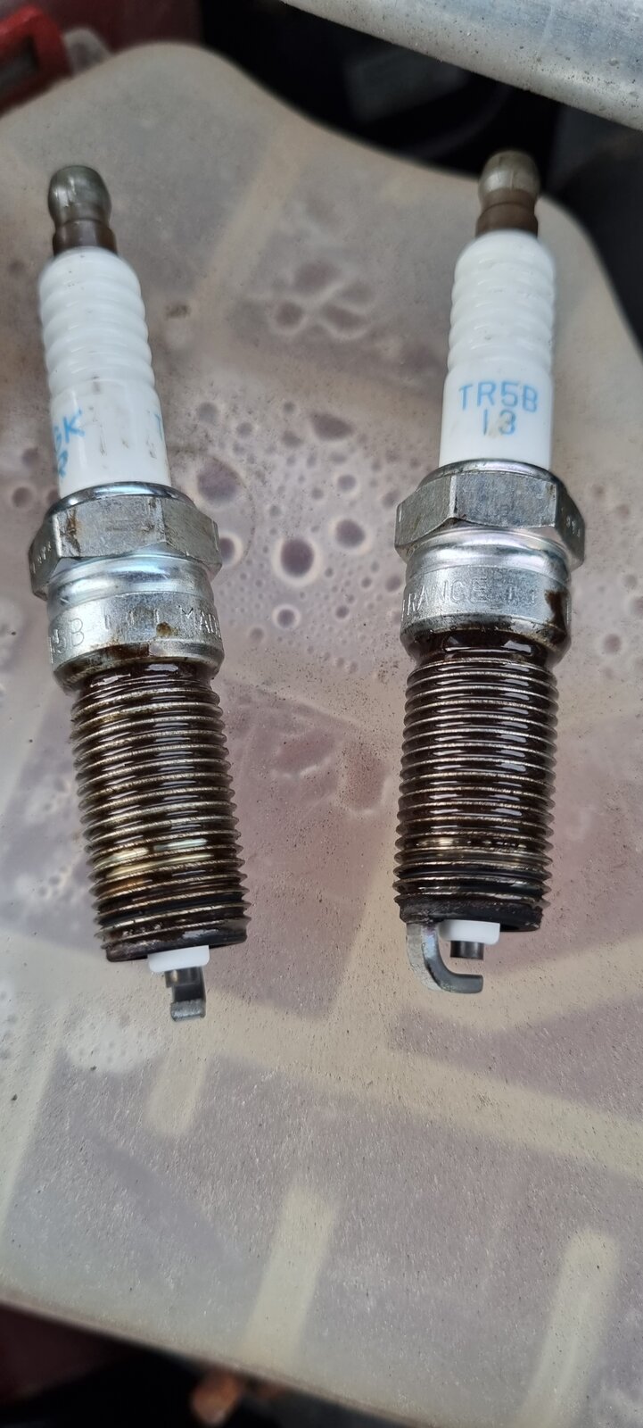

Hi we have an Mk7 Fiesta, 1.25 petrol, with the engine warning light on and a P0302 code when I plug my reader in. I've swapped out the spark plugs, ignition leads and coil pack to no avail. A garage did a compression test for me which was OK, and got some petrol system cleaner to put in the fuel tank. I've done this and filled it up with the good stuff (normally it's always supermarket fuel) and driven it for a couple of days but after clearing the code the light comes back on. Not sure if the cleaner has had chance to get to work on the injectors yet.

Had the plugs out again and switched them around, shone a torch into the plug holes and they were clean.
Ah, it’s the Zetec engine then.
If the plugs are the same colour, I’d wait for a diagnostic check - it could be a catalytic converter issue if it’s been replaced by a non standard item.

Yes they all look like this:
Hi so unfortunately the engine had to be stripped down and lots of work done including new exhaust valves fitted as the old ones had burned out. A very unexpected and unwelcome cost. They reckon this problem is on the increase since the new E10 petrol was introduced.
