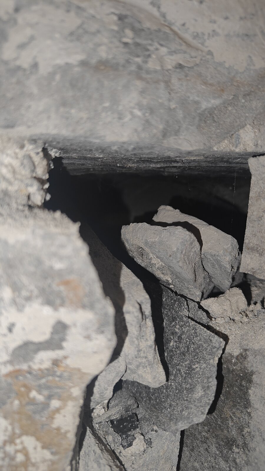

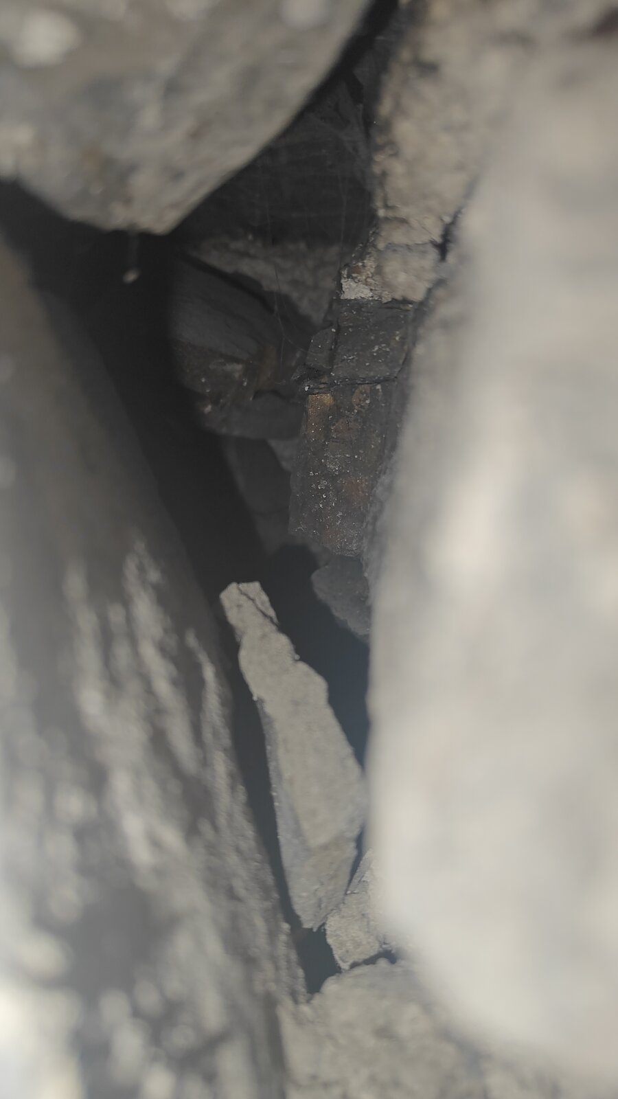

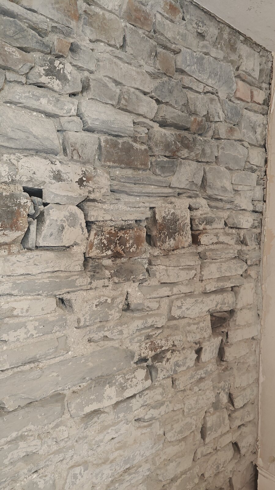

This is the wall and the voids I'm looking at. Some of them go back 12in or more. So I'm definitely not getting mortar in via normal pointing methods.
As someone said, maybe a mortar gun is the right way to go.
I think it makes sense to fill any air gap with supporting material while I have the opportunity since we plan to be in this house for 20+ years so I'd prefer to do it once and do it right.
Thanks for the pictures.
Similar to my wall - no need to worry about the voids, or unnecessarily fill them. That's just how they were built.
IMHO, there's the possibility of causing issues, if there were to be too great an intervention.
It looks like it will clean up beautifully, with some repointing with lime mortar - a nice feature wall?

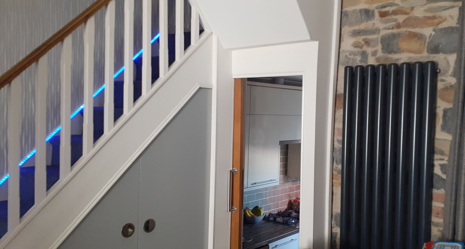

A small section of my wall, copied from another thread...
Your wall looks stunning! Great work.
Yes, I'm repointing 4 walls (bathroom gable, bathroom exterior, office exterior, and office gable). The office gable wall is the pictures. I think my plan is to remove the ceiling and have a feature wall that goes all the way floor to roof and there'll be stairs up to a loft. Then the 2 exterior walls and bathroom wall will all be done in insulated plasterboard for the best of breathability and insulation.
Thanks for your input and I think you might be right that I could cause issues if I do too much.
P.S. I'm in Aberystwyth, Wales, since I see you're also in Wales. Moved here from Vancouver 18 months ago so I'm still coming to terms with what buildings look like when there's no earthquake risk.
It's just how walls were built - face the flat side outwards on each side, don't care about the middle.
I've used a mortar gun before, they're great for this sort of thing. Alternatively just use a trowel with a float or board to repeatedly push fillets in until it pushes back against you.
Pourable lime grout is available
You could make up something similar with quicklime and sand.
While some voids are normal, when built they are backfilled roughly with smaller stones and mortar. If the voids have increased due to rain or plant ingress then grouting can provide good consolidation of the wall. Make sure it is pointed well because it can bleed out during the pour.
