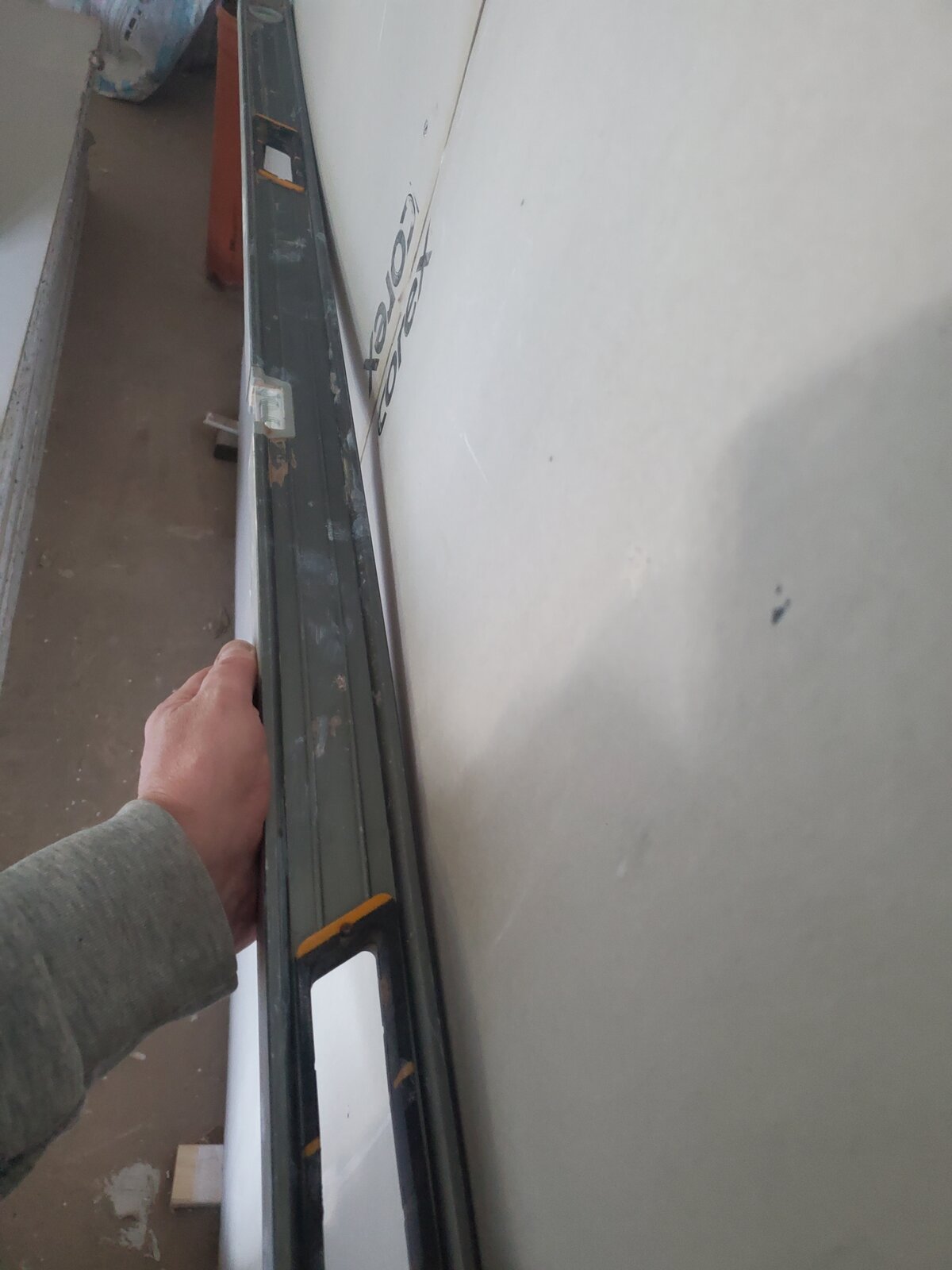

Can someone tell me the best way to fill these voids in between insulated plasterboards before skimming. Thanks
If the boards can be taken down still then packers behind held in place by the screws
