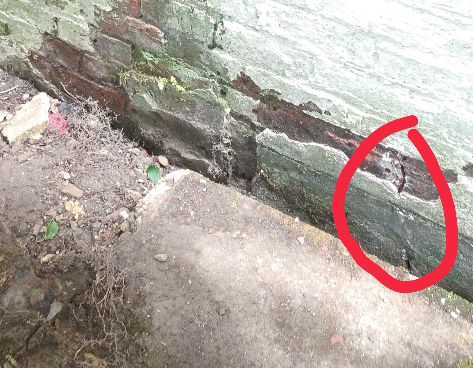

We've discovered a crack/gap in our solid brick external wall the bottom few courses of bricks. It was previously hidden until we prepared the house for repainting and appears to be historic/stable but at the bottom is a good finger width wide and in hindsight the position lines up with a very damp area inside... We had thought the DPC had failed but now think water is simply getting through the hole between bricks on the first course as rain pools here.
Pointing it seems an obvious solution but won't regular mortar allow rising damp? Is there some simple additive you can put in concrete in such cases? We've used waterproof render before but I've no idea what is special about it.

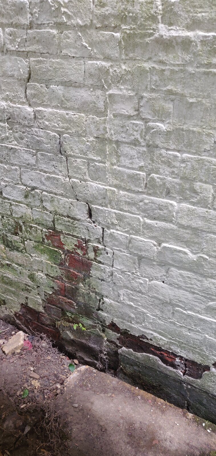

Managed some photos though it's under scaffold so not the best quality.
The crack is a few feet long but only widens very near the ground. It 'jumps' to the right the very last course which is where there's actually a gap right where water runs past.

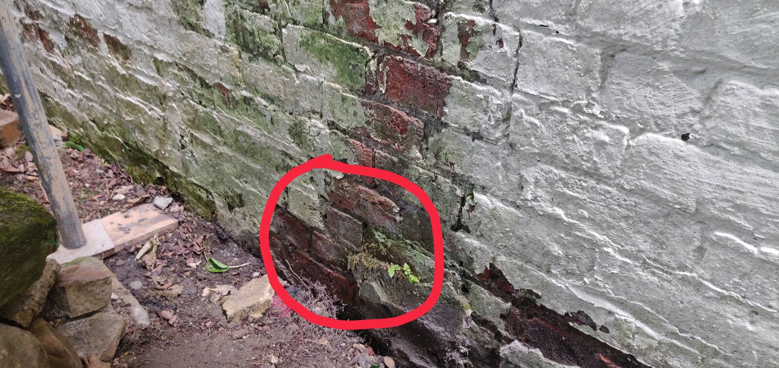

The bricks to the left were part buried and their mortar seems pretty badly eroded as well. There was a dry stone wall here which is a) why that bit isn't painted b) why we didn't see it sooner. We thought the damp was simply due to the dry stone wall up against the house.
The render looks really bad at the base because we started removing loose bits. Not sure that external render isn't making it worse!
We don't think there is active movement at least.
