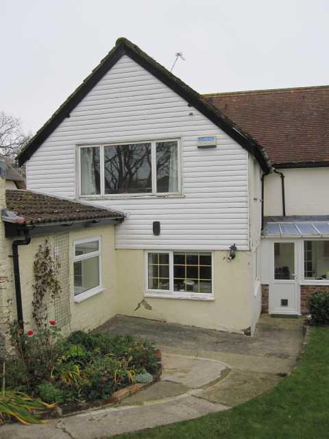

And then there are these other three windows. Two were set into a painted rendered wall; the third, the wall had been clad in uPVC.

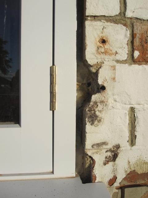

I told them I would be taking the render off to see what lay beneath. In the event (after they had made the windows) I took the render off and found a brick (soft bricks!) corner pillar to flint walls. The render was VERY hard cement render, which is why the walls were VERY damp. When I took the render off, many of the flints came too - it was rather scary ! They were held in by very crumbly lime mortar (well, sand, truth be told - scratch it, and it comes away) with deep and extensive voids.
When I took the render off round the windows, I found that there had been a previous window a couple of inches wider, with another rendered reveal on each side.
So I don't blame the joiners there. I'm making a new arris of strong lime mortar (NHL 5, 2:1) which I shall "point" to give an ashlar effect - it's all going to be painted.

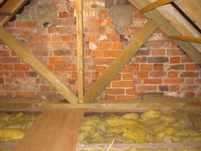

The other window - a very wide one - in the 9" brickwork gable wall was aluminium-framed, with 1" thick hardwood reveals internally, and a 1" thick hardwood soffit. But when I stripped off the cladding battens on the outside, I found that this hardwood formed a frame around the aluminium frame. In the loft still remains a chimney, demolished below ceiling level (and I think totally unsupported save by the corbel effect), which originally served a fireplace on the ground floor, and was cut out to make way for the window.

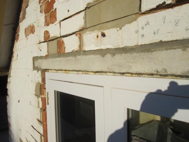

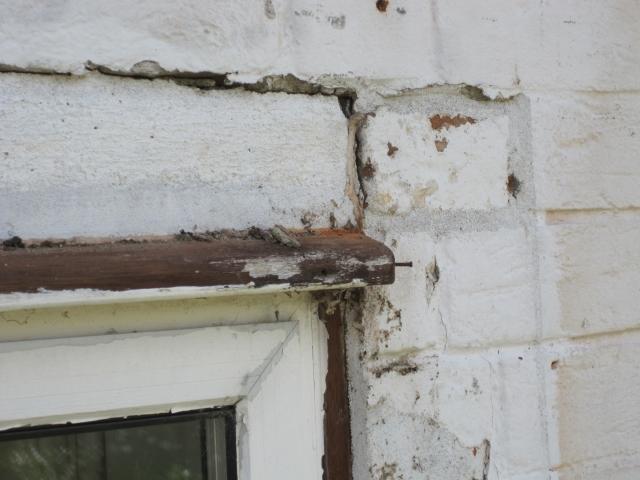

Upon removing the cladding battens, I discovered that the concrete lintel was the same length as the top of the hardwood frame, i.e. it did not extend into the brickwork at all ! So the hardwood frame was holding the lintel and the brickwork above it, including the old chimney ! Scary, or what !
So our joiners acquired a longer concrete lintel from a demolition site, removed the short one and installed the longer one. They also removed the ali window, and the hardwood reveal and the hardwood soffit, revealing two side-by-side 4 x 2 lintels holding the inner skin - and at least these were properly set into the brickwork on each side!
