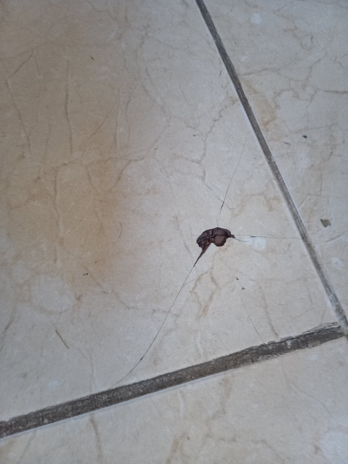

I, ahem, dropped a big mug down the stairs and it has made a real mess of one of the tiles. This is one of a couple of accidents and I'm just wondering if there's a product to use that will help me to make a half-decent job of filling it in. I'm far from a perfectionist and it couldn't really look much worse but any suggestions appreciated...

You can get clear 2 pack fillers that you add colorants to. You only need a small amount so perhaps use a standard two pack filler and add the correct coloured water based paints to it. You can use those small acrylic bottles of colour from cheapy art shops. only use a tiny amount of paint. It will stay tacky for longer than usual but will harden. You can experiment with building it up until you get the colours correct.
