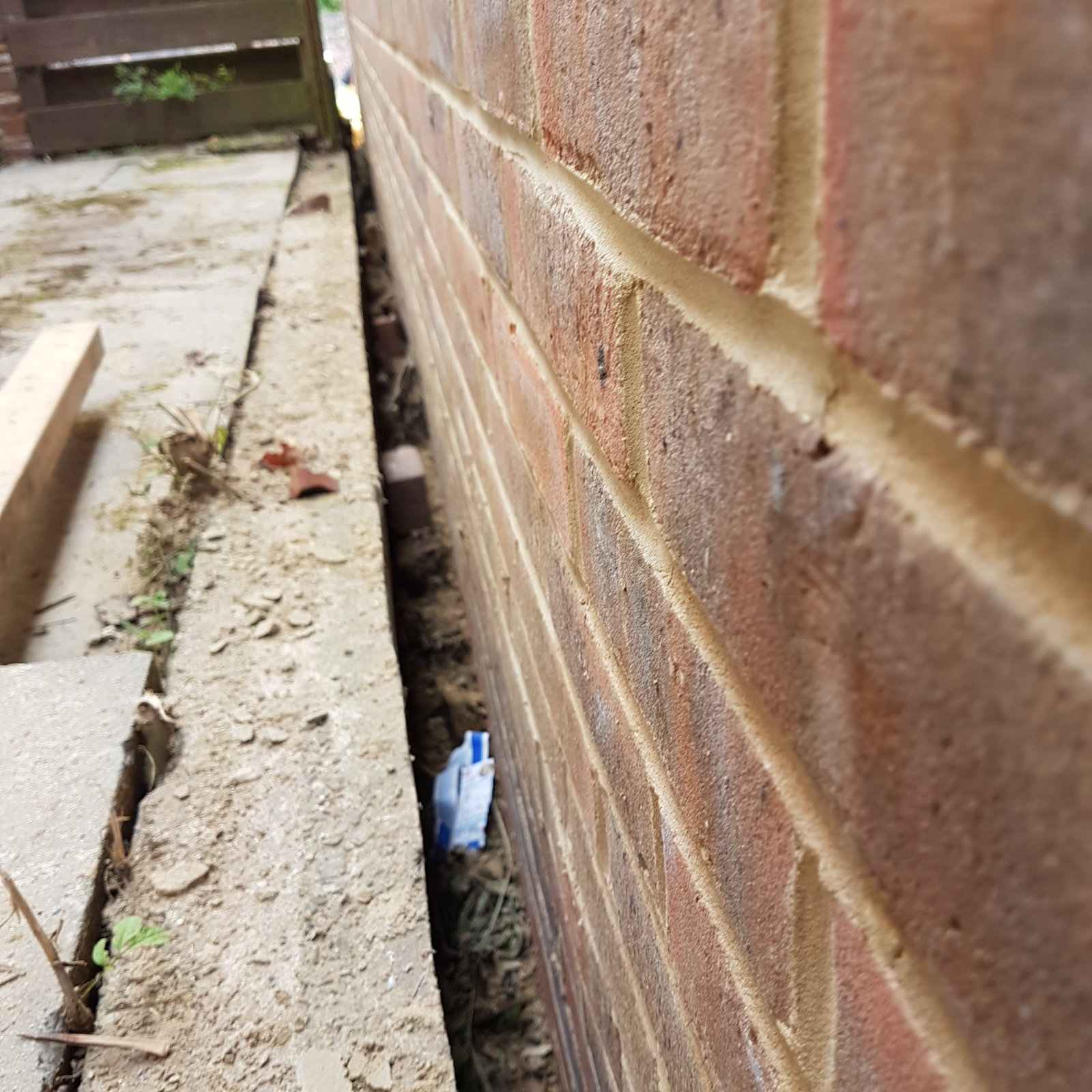

Hi,
I need to fill a gap (2 inches wide and about 6 inches deep) between my new extension and the neighbours concrete level. The damp course in the bricks is above the neighbours concrete, so I though I could fill it with gravel stones. Should I be worried about rain and fill it with concrete?
if there is a risk of damp, cobbles will be better, or as big as will fit with no sand or grit. Large stones are more resistant to capillarity.
