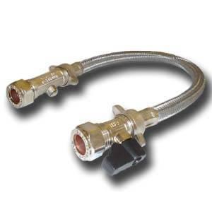

I have a a Glow worm 30SXi Whihc has a red flashing light which I assume is because of drop in pressure. its only 0.5 bar now. Could anyone tell me how to locate the filling loop on this type of boiler and how to top up.

Have a look under your boiler for something that looks like this,
if its not near your boiler it will probably be close to your hot water cylinder.
get out your manual, in the users pages it will show you how to do it, there is a tap under the boiler that fills it up,

thank you for your suggestions. I couldn't find the filling loop below the boiler. however I manage to find it in the airing cupboard. it was plumped in there rater than below the boiler.

I found the filling loop plumbed in the airing cupboard just as skram said.
Looked exactly like picasso's picture.
