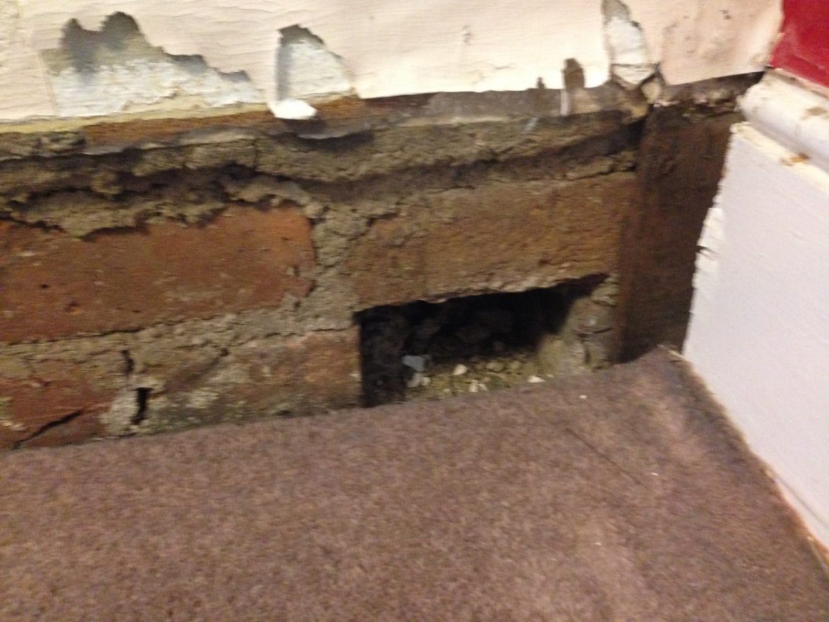

Hi,
I am removing skirting from one side of my living room (ground floor) to install bookshelves right up against the wall and also to prevent mice from running around, scratching and making holes after I’ve put the shelves up. Being an old Victorian house there is a bare brick behind the 8” high skirting and I want to fill it so I want to ask some advice and run my draft plan past the experts.
As my house has joists and floorboards, I am assuming the DPC (damp proof course) will be below joist level. I will double check this when I pull up the carpet and a couple of floorboards but i do remember there being a good 1 foot of space beneath the joists so assume the DPC should be below floorboard level. Then, I plan to place some cardboard or hardboard on top of the floorboard, which I can pull out once the plaster is dry to prevent the plaster bonding the boards to the wall and also to prevent plaster falling into the cavity. Then I will feed the wires to the sockets through some conduit that will later be set into the plaster. Then, I will clean off any loose dust and plaster from the brick work and the bottom of the plaster, and then spray it lightly with water. Then I will use plaster to fill the gap roughly up to the level of the wall. Then I will scrape it even to the level of the wall once at the right stage of drying out.
Questions:
1 - Does that general plan sound okay?
2 - Which type of conduit shall I use to bury the wires into the plaster?
3 - Which type of plaster shall I use, bonding, hardwall, multi purpose, or something else? I once, upon someone's advice, tried a similar task with sand and cement and it wouldn’t stick and keep falling off. Someone then suggested adding bonding plaster to the sand and cement mix to make it sticky; is there such a thing?
Thanks in advance

I've discovered there are 4 cavities (at the bottom along the length of the wall with a very cold draft coming through them. Can anyone tell me what they are for? I was going to plug them with something and plaster over.

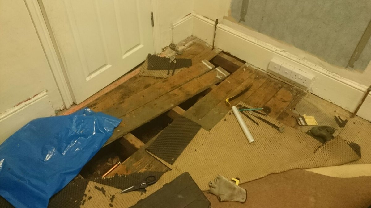

Regarding the sockets, the original wiring comes into the socket on the right and then the other two isolator switches branch off that.
I'm attaching pic's if that helps.

The cavities are most likely to ventilate the under-floor space and prevent rot. Don't block them up.
Edit - actually belay that, of course they're above finished floor level, so no idea.

The outlets and FCU's arrangements need posting on the elec forum. They are surface devices, and you should be installing flush devices sunk into the plaster above the skirting (at your selected height) not surface mounted on the skirting.
If the floor boards were up then possible wiring alterations could be suggested, esp. if by "original wiring" you have pre-modern cable?
Fill the holes with bits of brick and mortar or similar.
The vertical wood pads should be left in position for re-fixing the skirting.
Your skirting is a simple 8" Torus not a unique Victorian profile.

Yep, I did think of that for a moment before thinking they're above floor level. Also, there are large ventilations paths beneath the boards.

I have one pick that shows the rad pipes and the sockets just after the plumber came to re-route piping. I'll attach it her.
You are working over an uncovered carpet that should have been rolled back.
It was rolled back. i just vacuumed and unrolled before taking the pic.
You've now, so you say, partly damaged the skirtings - and the plaster and decorations above the skirtings, that should have been released with a knife, have also been slightly damaged.
It's all in a very bad state and that's how we got it. To be honest, I don't feel much of it is worth saving. I guess I make a different thread on the elec forum for the plugs, if needed.
