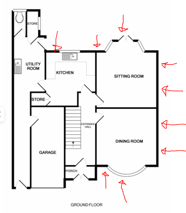

Hi all,
I am revisiting my plan discussed here https://www.diynot.com/diy/threads/filling-void-under-suspended-floor.615142/ to fill my suspended floor.
I dropped a tape down into the floor and found that from the bottom to the top of the finished floor is 700mm.
What I am thinking:
700mm - 30mm for tiles
- 70mm for UFH in screed
- 120mm for PIR insulation
= 480mm of Type 1 MOT fill.
18m² floor area * 0.48 = a filled volume of 8.64m³ at 1.5ton/m³ = 13 tonnes of material.
The first price I saw for this online loose tipped was £800.
I am thinking about filling the "Dining Room" first, the red arrows show air brick locations so there will be reduced airflow to the rear room which I will tackle within a year.

The previous thread received a lot of naysaying about this plan from construction industry professionals and experienced DIYers.
Phatboys solution was the one that seemed the most sensible. You don't lose floor height with UFH if it all goes between the joists. You can still use a screeded system between the joists, although you may need extra timbers.
