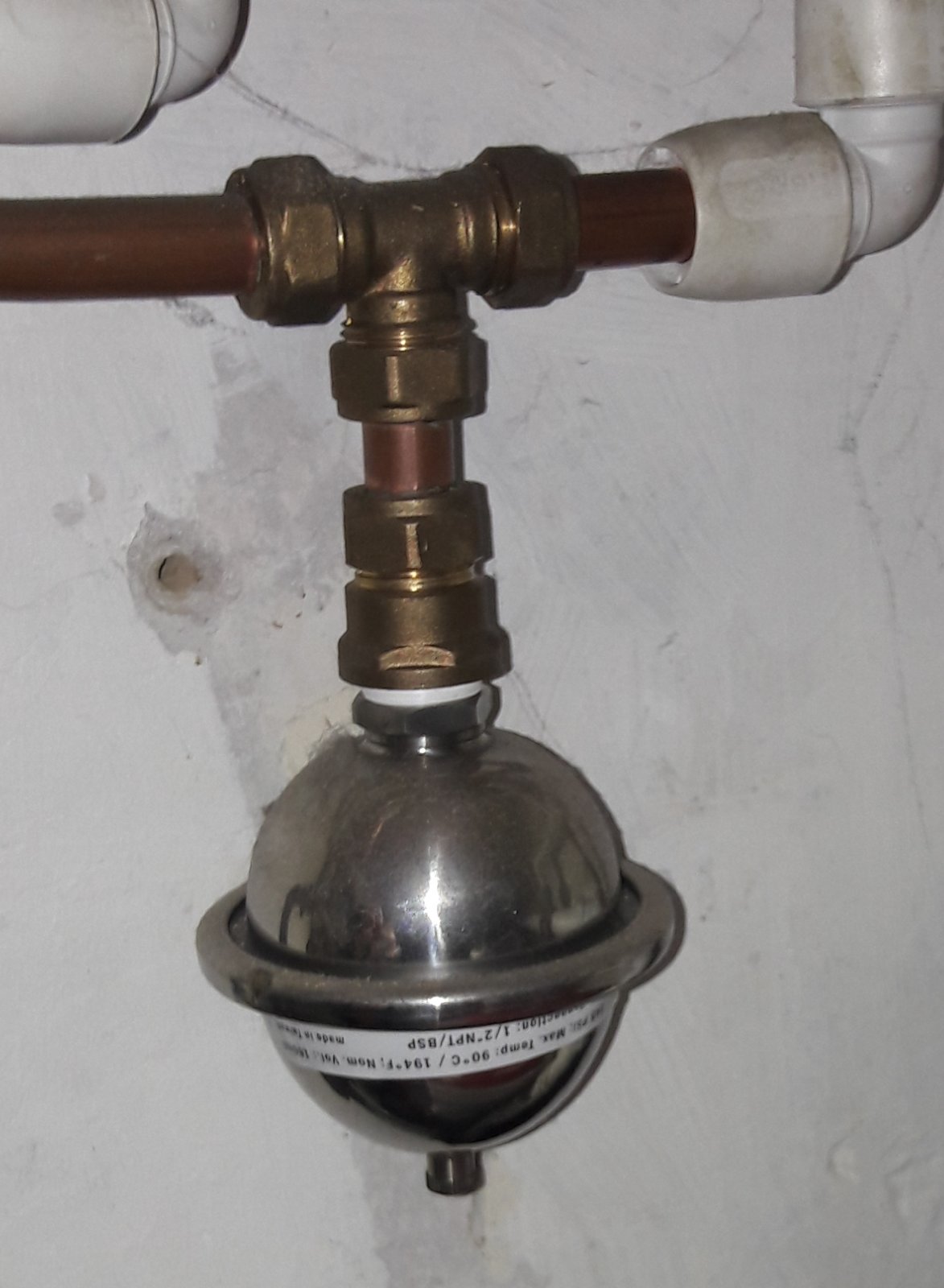

Hi everyone,
We recently had our boiler serviced, and the engineer recommended that we get a magnetic sludge filter fitted (Magnatec or similar). The boiler already has a filter of some kind fitted to the cold water intake - pic attached. I'm not sure what this is, but I have a feeling it's for limescale, not sludge. We live in a very hard water area.
Can anyone identify the filter (or whatever it is) in the pic, and / or advise regarding whether a Magnatec filter would do something different?
The boiler is a Glow-Worm Flexicom 30 CX, about eight years old.
Grateful for any advice.
James.
Yes, it's a shock arrestor. It may have been fitted because you have a deadleg somewhere in the pipework, and when a cold tap was turned off, it was fooling the boiler into thinking there was hot water demand and firing up momentarily.
You need to fit a magnetic filter to the large return pipe on right side of boiler to filter out rust particles from inside the rads as the system's water returns to the boiler. This will mean that the filter will stop the rust from entering boiler and causing damage. This damage can reduce the life of your boiler. Engineer probably found sludge/rust particles when examining boiler. All of this is nothing to do with the water that goes through boiler to hot taps.
