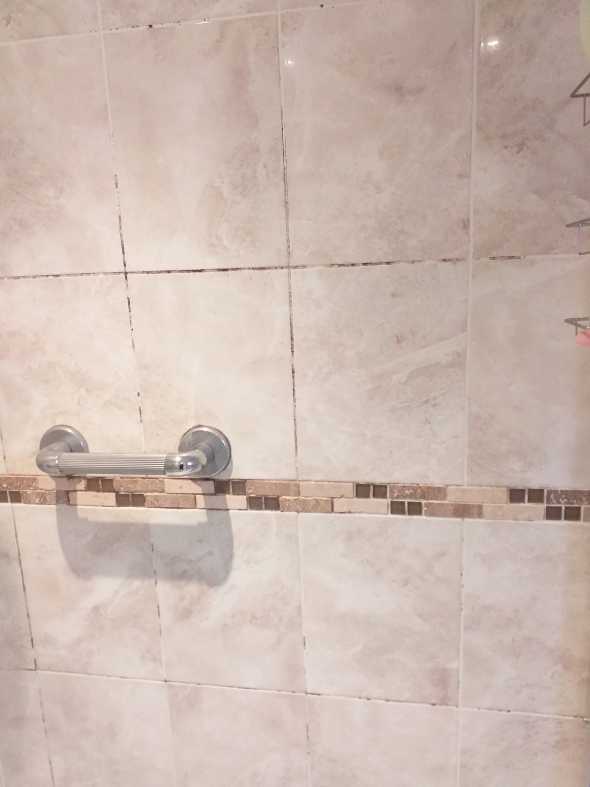

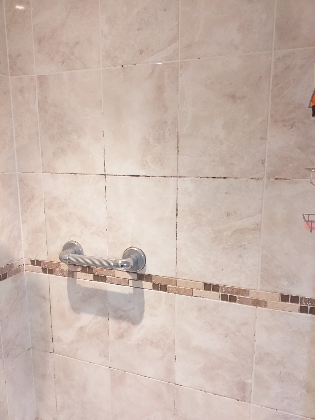

The grout between the tiles is filthy. Can it be cleaned or does it need removing? I remember someone mentioning a tool to remove it in a previous post. Is it easy using a tool?
That brush sounds good. I guess leaving the neat bleach a long time might work. Not sure how you can keep it on the surface as it's vertical.
Is the dirt mostly mould? Maybe something like Cillit Bang mould cleaner is the best place to start.

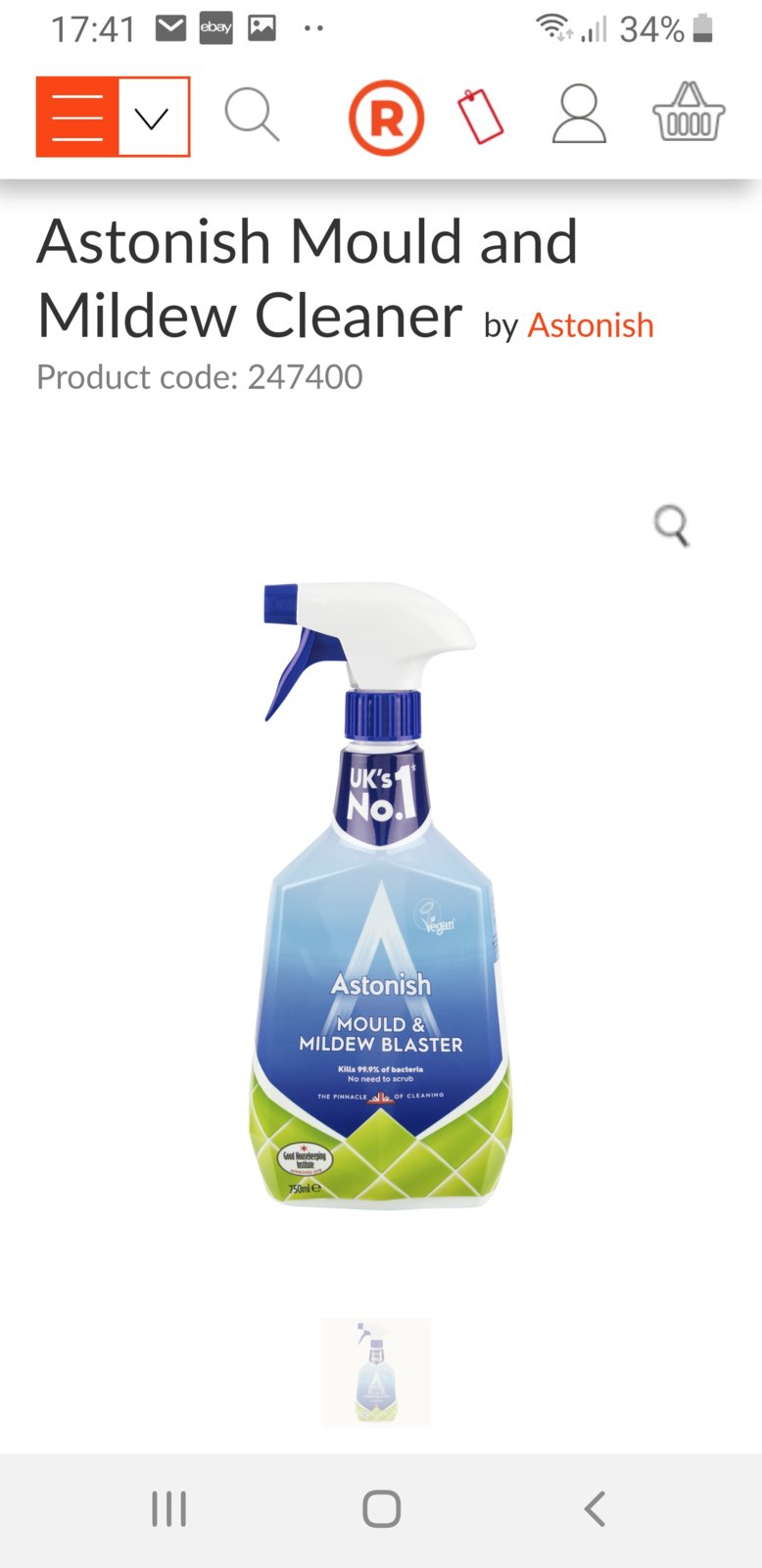

Ours was worse and due to mould.
1 bottle of this transformed it!.
I sprayed on, left 20mins rinsed down and re-applied (did this approx 6 times).
Bathroom is like new.
Can't believe it's only a £1 a bottle!.

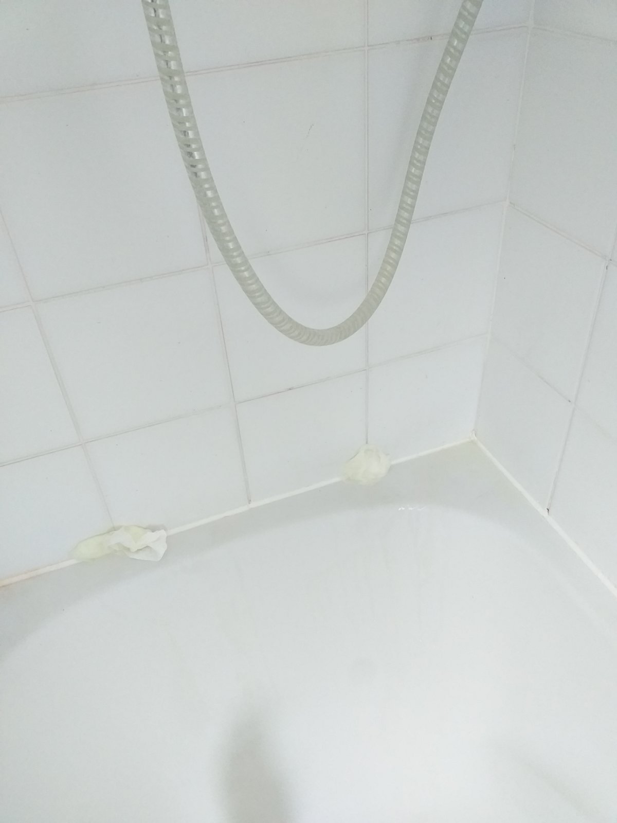

I'll give it a go after neat bleach pushed push into grout with kitchen roll
Got to say, if that was a cleaning issue how on earth did you let it get so bad?
Has it never been cleaned?
Glad you can see the benefit of some elbow grease
