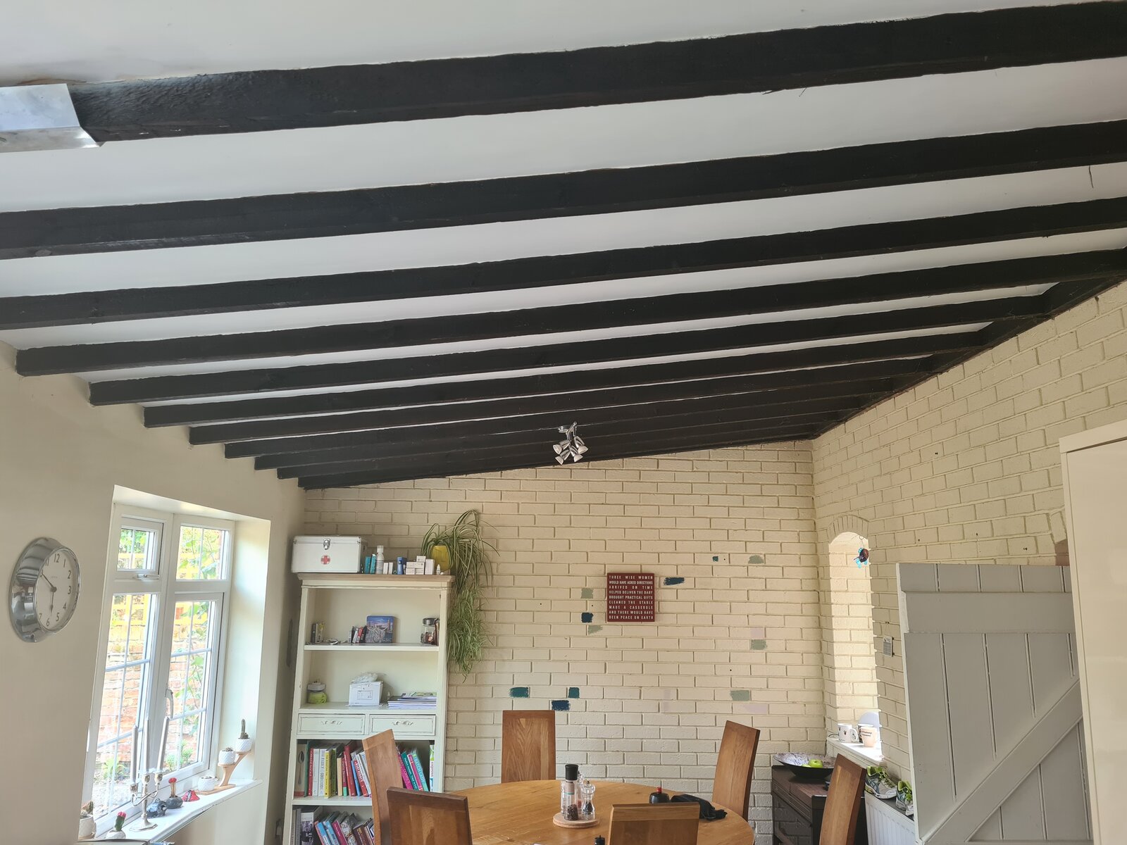

Started the extension roof replacement back in July and got the outside done by the end of August. Been working on the inside since.
Couldn't get a plasterer at all. No one taking any work.
Decided to go with boards and filler. Apprehensive but the results have been way above my expectations.
Don't think I'll bother with plaster again. Unless I have too.
Dusty as hell but only for 3 days.
Before ripping the top off - with beams

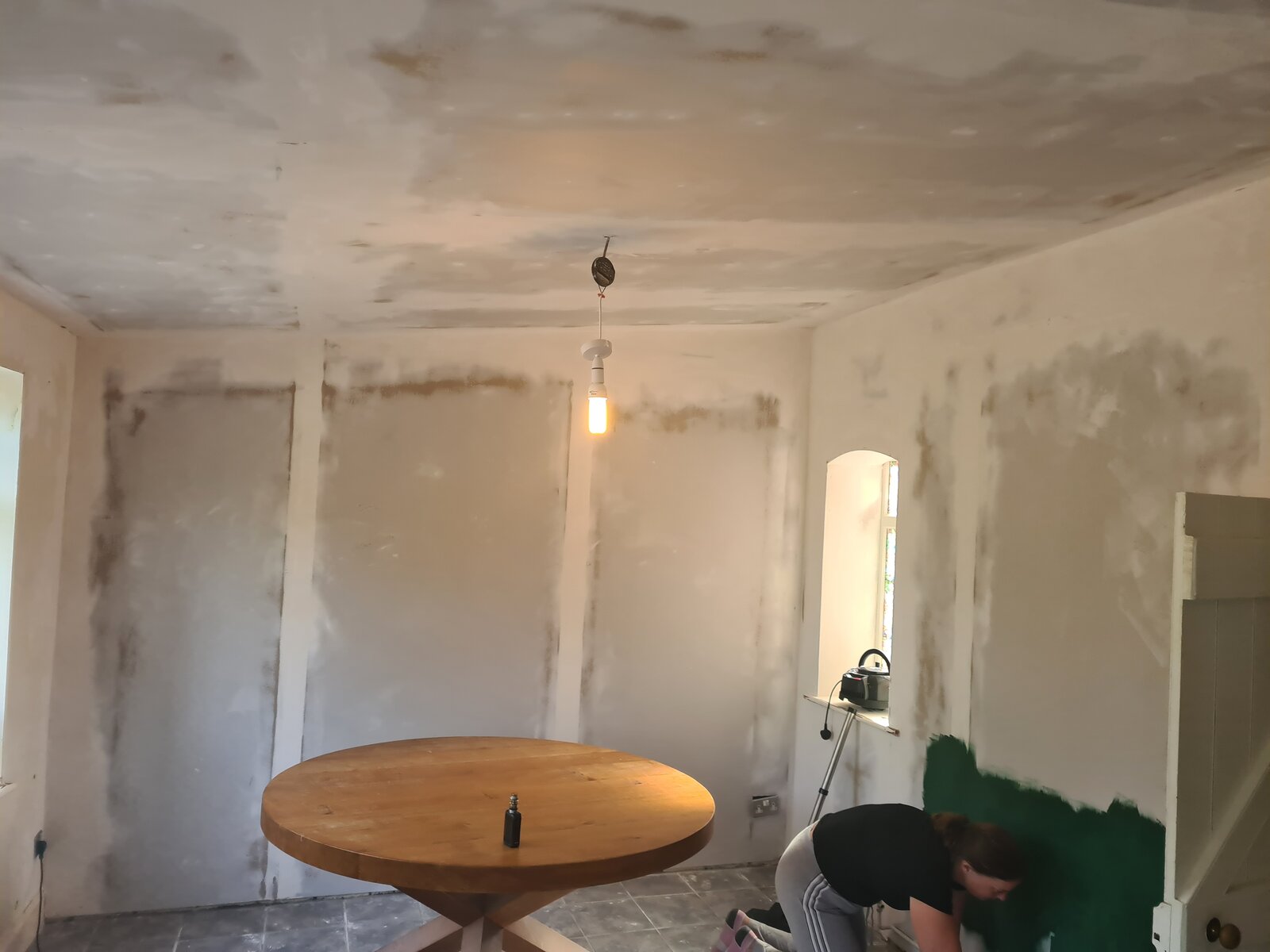

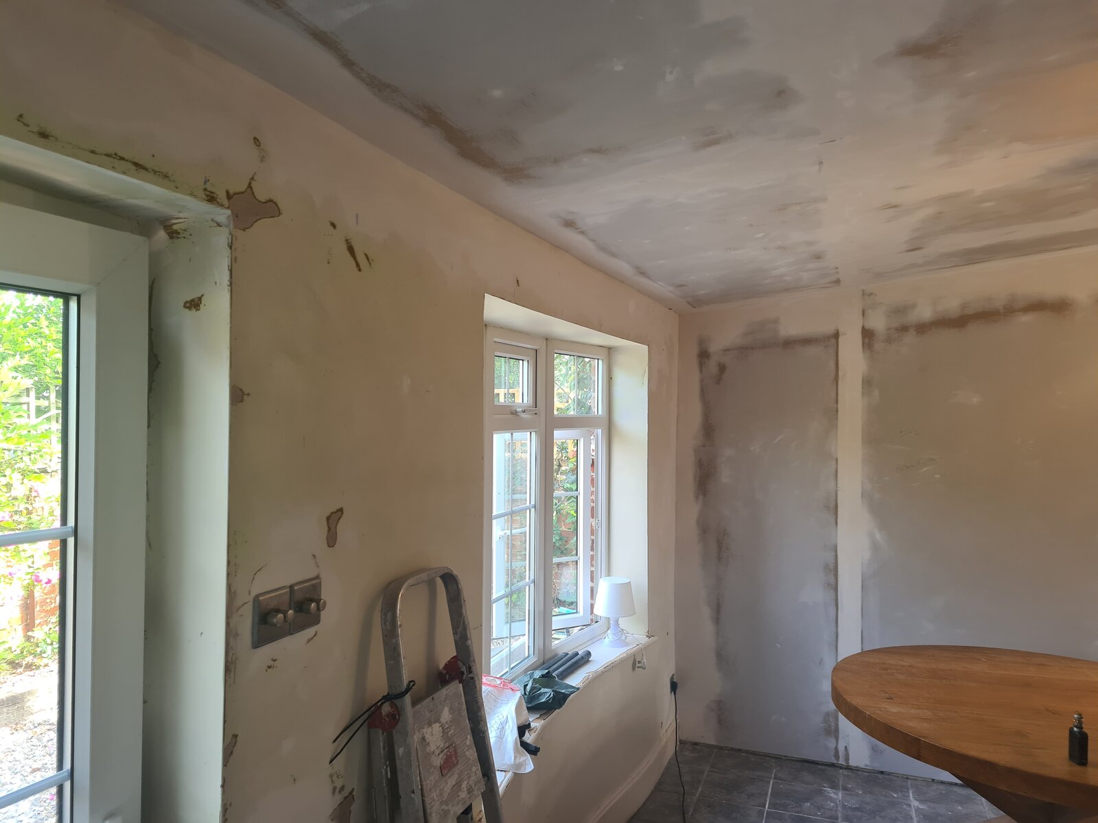

A bit of in between while filling and sanding.

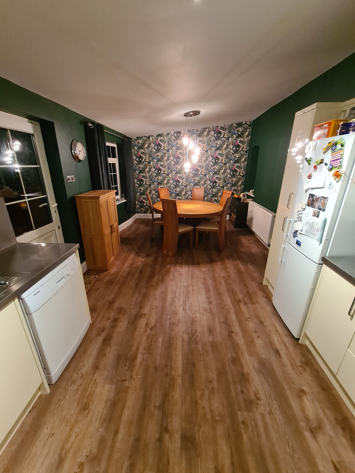

After beams gone and not any plaster used.
Job is most definitely a good un.
Just waiting on the floor fitters in November
This looks great. What was your process for getting the plasterboard to a state where it was ready for painting?
Only used tapered boards - plasterboard Jack saved me here - and filled the gaps using 60min filler. Used around 20kg of it.
Messy but a big industrial hoover attached to my sander was great.
There are small imperfections that I can see when they catch the light but nothing really.
Went straight on with the paint.
Covered like a dream!
Floor going down next week finally!

It looks great! Gives me inspiration for getting my new extension battened and plaster-boarded.
Can I ask how it was filling the tapered boards and what you did for the un-tapered edges (where you cut the boards)? I'm not having mine skimmed when the boards are going on perfectly flat walls.
It was okay. The tapered edges required less but, there were many areas I had to feather out over the tapered edge due to very uneven beams.
The untapered edges were much tougher. I feathered out a long way in some places. On one wall I'd nearly skimmed it all. But, that meant that I could sand well out and create a really steady join.
I used tape and not mesh and once you get the hang of it the joints vanish. I also used a plasterers trowel for the final top coat of filler and with a wet sponge managed to get a lovely edge.
All corners were finished with internal and external bead/tape just like normal but, as the house is very old I used reinforced tape in the ceiling to wall corners.
