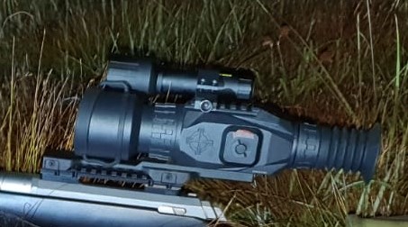

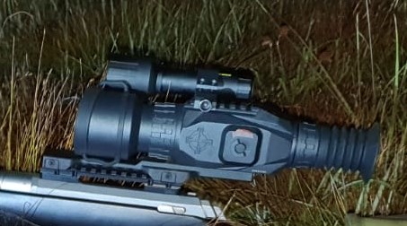

Andy, never thought of that, we have a very expensive and powerful TI riflescope and binos, I'll give them a try. Thank you.
