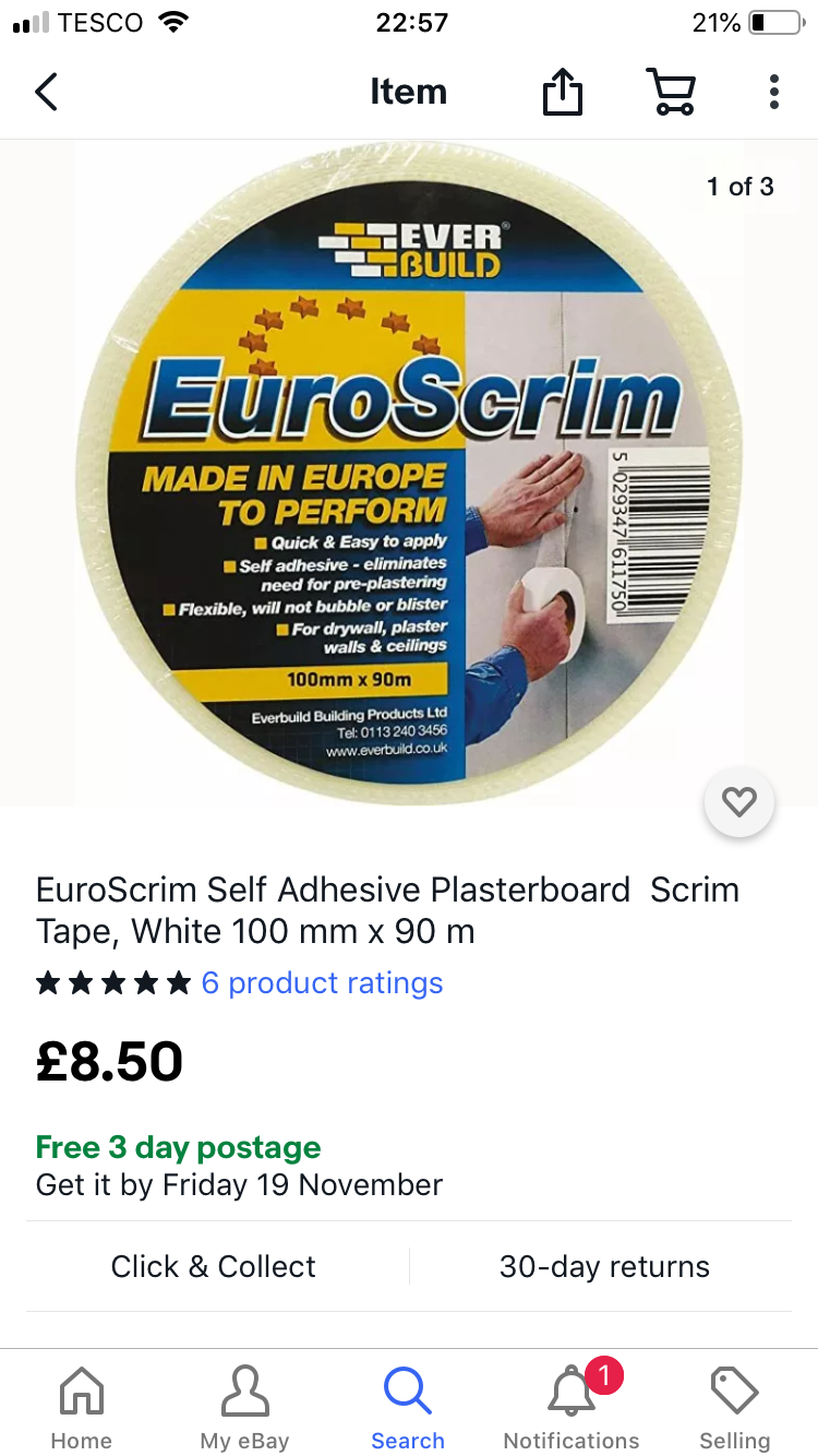

I have a wall that has a weak joint in it between brick and blockwork from the original construction. I believe this will be prone to continuous cracking. I am finishing the room and was planning on just skimming the wall but worried this will crack for ever more.
I would rather not overboard the wall if it can be avoided but it is an option. Is there any form of mesh or other method that can be plastered in to prevent cracking?
scrim tape the cracks and any other areas that may crack , like over and around the door or window .
you can buy a 4” wide scrim tape and do the whole wall if you wanted to. that would cure it.
plasprime the whole wall ,over the scrim tape and skim.
watery pva the wall the day before sticking the scrim on .
