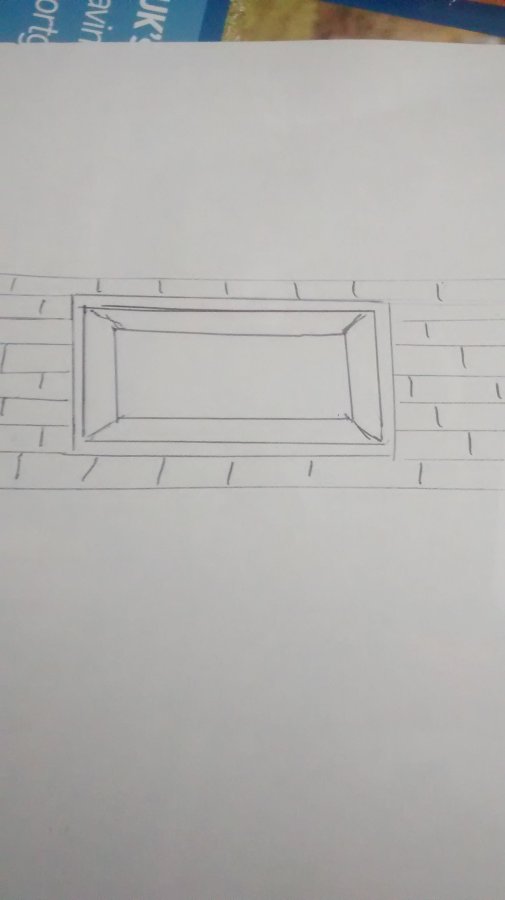

I'm having a false chimney breast constructed to house TV, fire, etc. It's faced with split face slate tiles and I'm getting to the stage that the apertures for the TV and Sky box, etc, need finishing. I want to have these apertures skimmed and painted, but I'm struggling to figure-out how the openings should be tackled. Also, whether to leave the edges of the split face tiles visible, or cover them with something. Thoughts?

I've spent quite a bit of time studying your pictures more so than usual this is another job where not a lot of thought has gone into it if you want to have those rough tiles the best thing would be to have the reveals sticking out and have the tiles butted up to them, then cut 4 of strips of plasterboard attatch them to the edges of the plasterboard so it now looks like tiles are going behind then cut further strips for the edges so now the edges of tiles are completely encased then dryline or skim , if you have room you can still do it reline reveals with slightly longer boards and follow instructions above
Not much you can do with that tbh just skimming inside and leaving tiles like that will look awful I'm having second thoughts about my solution now
