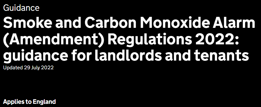

I think the confusion with the regs are between a rented property and a non rented property -- perhaps
Looking at ....
.... I find ....
The regulations do not stipulate the type of alarms (such as mains powered (‘hard-wired’) or battery powered) that should be installed.
We recommend that landlords choose the type of smoke alarms based on the needs of their building and their tenants, and that those alarms are compliant with British Standards BS 5839-6. Where battery powered alarms are selected, alarms with ‘sealed for life’ batteries rather than alarms with replaceable batteries are the better option.
.... and ....
The regulations do not stipulate where the alarms should be placed.
At least one smoke alarm should be installed on every storey which is used as living accommodation.
Landlords should follow the individual manufacturer’s instructions when installing the alarms. However, in general, smoke alarms should be fixed to the ceiling in a circulation space, i.e. a hall or a landing.
.... so (unless things have changed since 2022) no requirement for mains-powered - in England. That leaves Wales and Scotland (and NI) to be considered!
