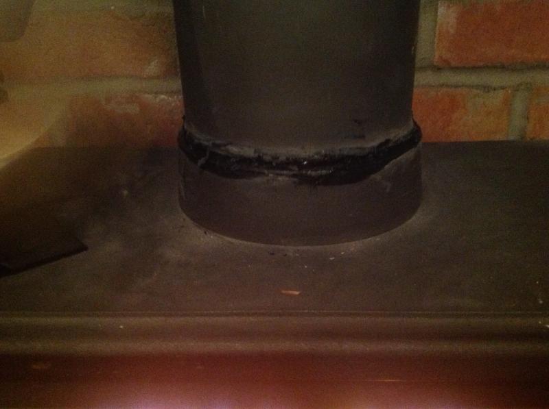

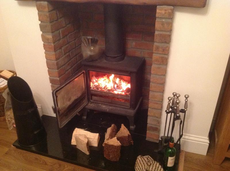

Twice now the fire cement has cracked on the join between the flu and my wood burner. I imagine this is down to the flu expanding and contracting during and after use.
Is there a more suitable cement or putty that is flexible and withstands very high temperatures?

If its cracking then the fit between the stove spigot and flue must be excessive.
First job is address this issue.
Post up an image.

what did you do step by step to apply the cement?
It was pre mixed so I just put it on my finger and rubbed it into the gap around the flue
The cement dried hard though so when the flue expands it crackes causing gaps. I tried the silicone as I presume it would of been flexible
You must use fire cement here. Black is available.
The flues must be separated and cleaned and a coating of fire cement is applied to both " contact" surfaces of the "male" spigot and "female" socket ends.
When they are connected enough should squeeze out to form a neat capping. This will not crack if properly done and will not leak.

HT silicone is very dangerous in this situation. Your hetas installer should be doing this work.
