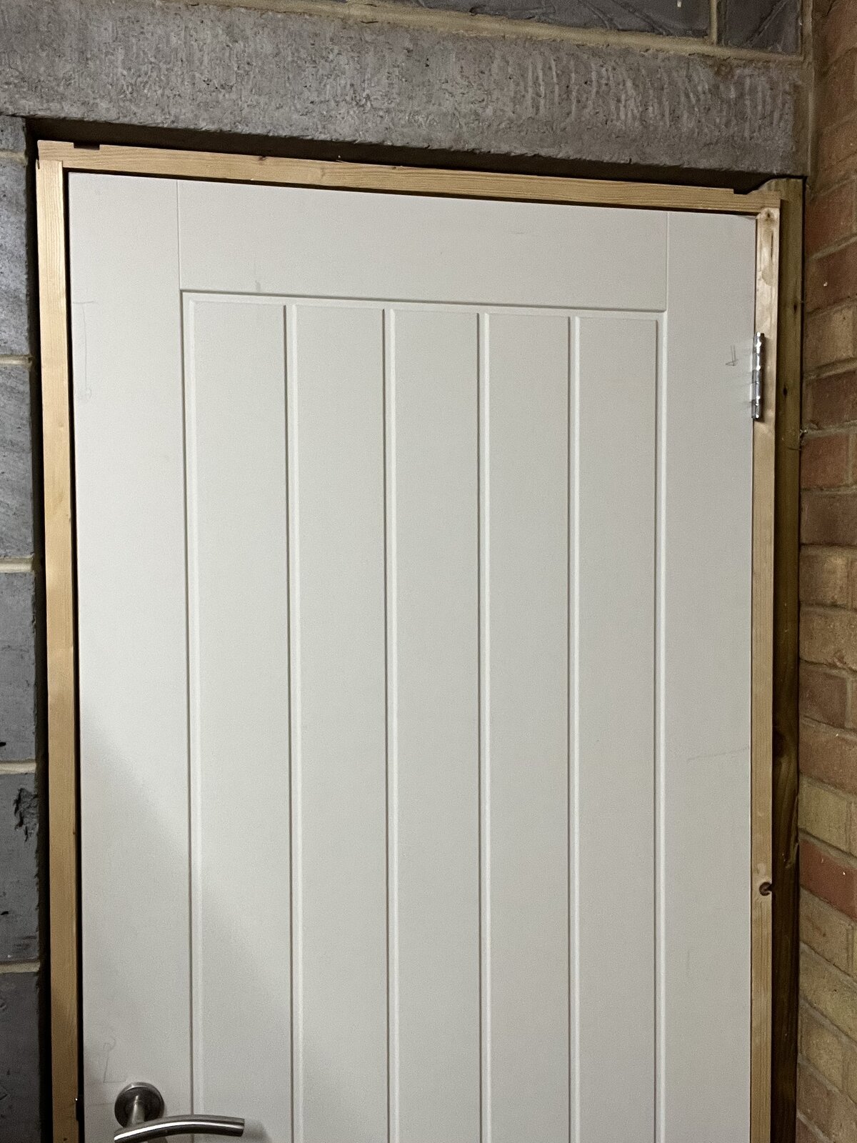

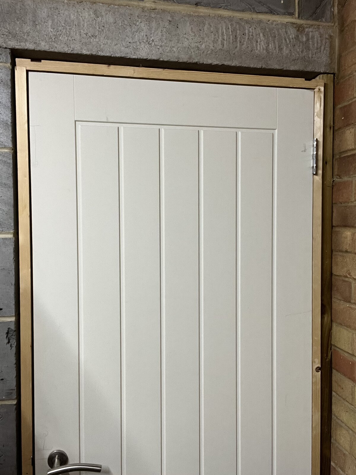

Hi
I have a fire door fitted between an attached garage and utility room, it’s plastered on the utility room side but not the garage and I suspect building control will want something in the gaps.
Any idea what I can use, hinge side there is room for fire board but it’s only 50mm, there’s a 25mm gap between the door lining and the lintel and a 15mm gap on the opening side.
If the gap is more than 5mm you are supposed to pack it with mineral wool to within 10mm of the surface then fill the last 10mm with intumescent caulk (a messy job). Fire foam is nowadays regarded as suspect because it can deteriorate over time and lose its' fire retardant properties. The gap between the door and tbe frame should be 2 to 4mm at the be top and sides and not more than 4mm at the bottom (current regs)
