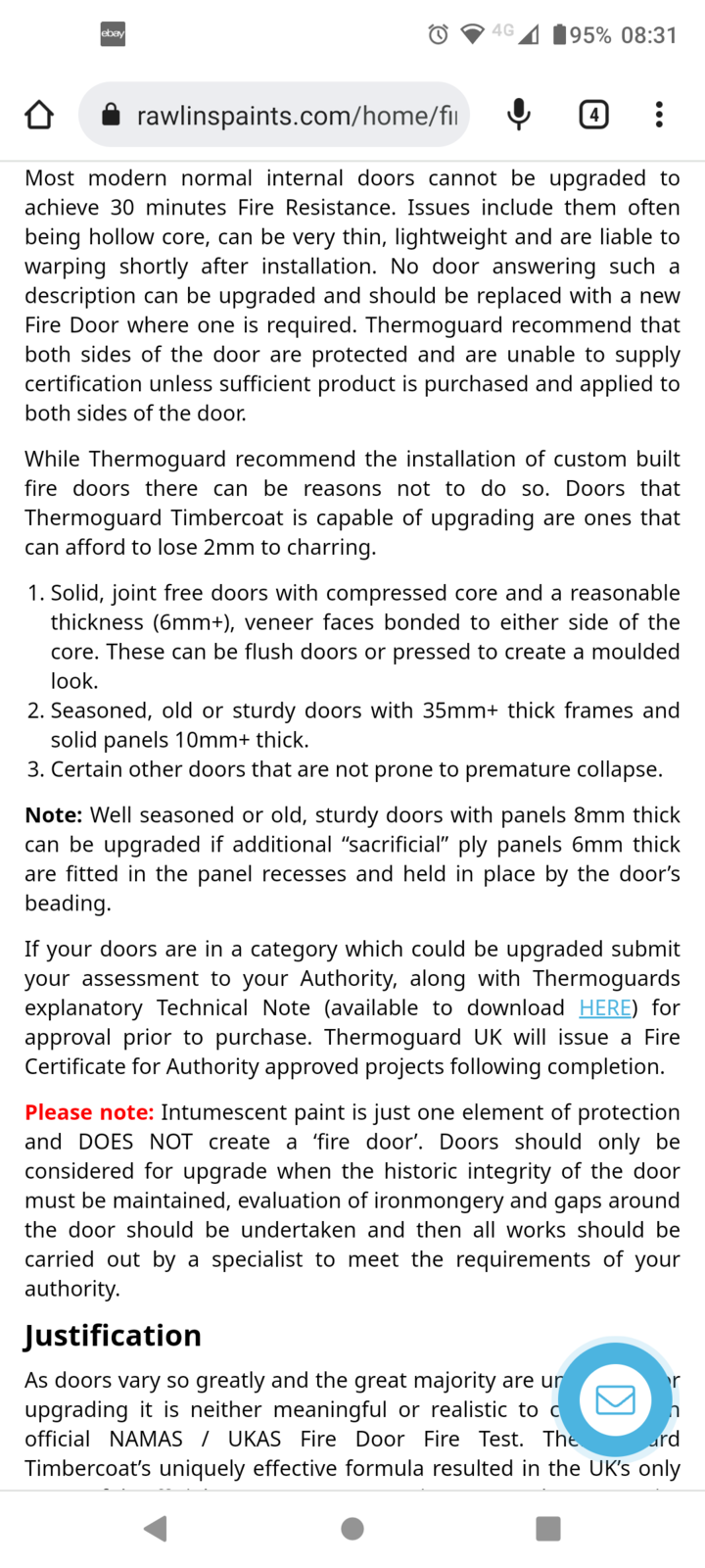

I presume you've looked at this - if your doors are as solid as you say then they may be upgradeable. Looks like you submit an "assessment", the technical note and presumably your proposals in terms of hinges and intumescent strips. Also looks like you'd need to convince your BC that you are enough of a "specialist" to do the work.
Yep. That's the stuff I'm on about. I've emailed them for their spec and info to present to the BCO. Also working out a price. To be honest, it's expensive stuff. Especially as it's 4 coats of the base paint and 2 of the top..... Plus seals and hinges. Pretty much the cost of a fire door. But I'd only need to coat 7 of the 11 so there's possible saving there.
