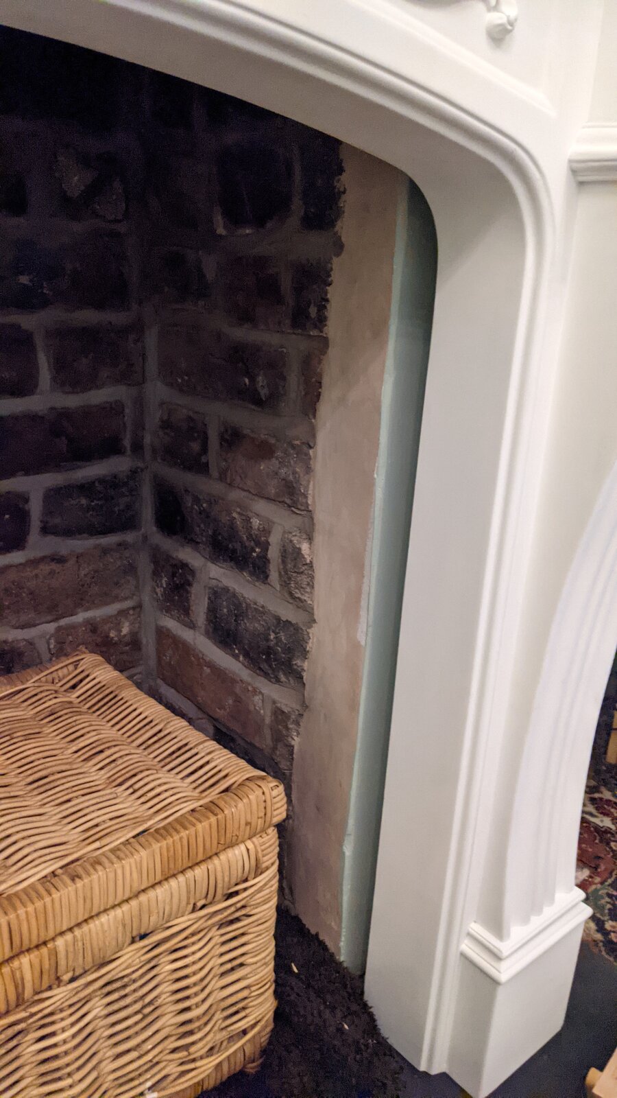

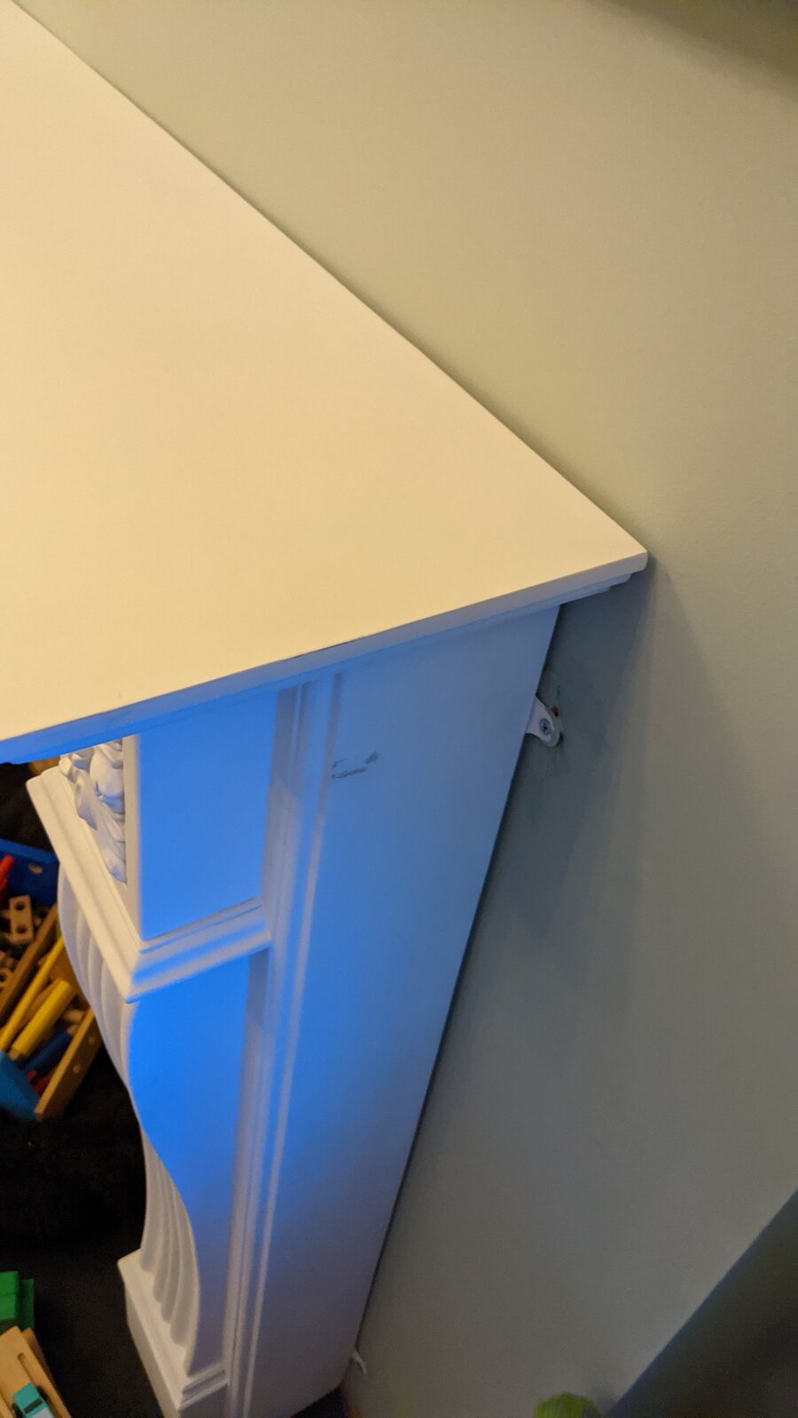

Hi Everyone,
We have bought a couple of fire surrounds and it seems that the inner legs don't fully reach the wall despite all the other parts of the surround being flush to the wall (attached pictures). Anyone know why this is or how to make this look half decent? I don't even know where to start. Thanks very much

It seems your wall could be out, by quite a bit, but have you tried pushing it in further on the inner side?
It's not the wall it seems the outer legs of the fire surround are 20cm and the inner side of the legs are 17cm. I've seen this with other surrounds before and don't really know how to neaten the gaps.

Isn't the outside part meant to be sunk into the plaster so that those tabs screw to the brick rather than being screwed to the face of the plaster?
Or is it designed to have a 30mm thick marble insert surrounding the fire?
That's exactly it, a marble insert went in there originally. It's how to fill that space and also blend in with the brickwork

The business of Anchoring your surround tightly to the wall, and concealing the fixing lugs is a simple matter.

The surrounds are usually installed, by cutting the plaster out so the surround can be fixed flat back directly onto bare brick, then the plaster made good around it also covering the fixing brackets.
That's really helpful, I didn't know that. Once they are in they become a permanent feature then? Hmm in that case do you have any advice to making do with what we've got? :-/. Thanks again
Yes, chop in back to the wall, as they are designed to be installed and make good the plaster around the edge. It will look a proper job then, rather than something just leant against the wall.
