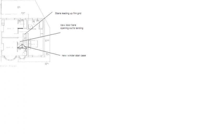

Recently purchased a property that came with planning approval for loft conversion and single storey rear extn and double on side. I would like to make some changes to the plan and would like to check feasibility of my proposalm before contacting the original architect and contacting LA for ammendment/re-submittal.

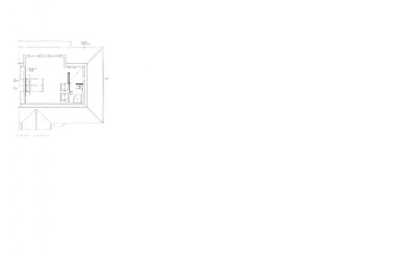

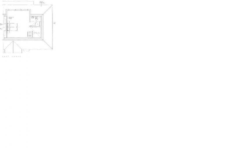

On the original plan the stairs were located in the box room running parallel and over extg stairs. I would like to alter this to a winder style staircase starting just after the original door into the box room, 2 steps up then kite to the left followed by one step up then kite again then straight above the extg stairs. 2M head height will be achieved. What this then achieves is the remaining part of the box room can become an ensuite to the orignal master bedroom. I will change all doors & frames to all rooms on both gnd and 1st floor to FD30 door sets (is this to current spec). Question is for the loft bedroom can the door at the bottom (required if I turn into HMO for separation) of the stairs be created just after the first stair and open out onto the extg landing or is there a requirement for it to open inwards or a minimum dimension required for the door to open onto the extg landing.
With respect to HMO are there any additonal requirements as information on this seems very limited? I will of course get anything confirmed in writing but would like to have a better understanding before contacting LA and architect.
Attached are the copies of the plans and my edits
The position of the door in relation to the stair is very clearly set out in Part K of the Building Regs http://www.planningportal.gov.uk/Pp...gportal.gov.uk/uploads/br/BR_PDF_ADK_1998.pdf (diagram 6 on page 8 ) the door can be at the bottom or the top BTW.

Landings are required at the top and bottom of a staircase. The landing depth is to be the same width as the staircase. However, this dimension can be min. 400mm if you have a door swinging across the landing. There is no minimum width for a staircase (in a dwelling). You just have to use common sense applying it to moving furniture in/out of the loft room.

Your plans are a little hard to decipher tbh as they're quite small. A decent architect or technician will indicate Building Regs compliant layouts at Planning stage, bit slack tbh! Do not feel obliged to uses the same Architects for the Building Regs drawings, this amendment will not affect the approved panning application unless the building is listed which I am sure it is not anyway. ;) Persist with your LA, who is your local council BTW? Presume you realise the approved planning application is only valid for 3 years? Better get your skates on or see if you can extend the deadline.

Thanks very much, will proceed as was, it appears like I am more or less on the mark. The rooms will be easily large enough as per the table, have the added benefit of the ensuite each and will be of a very high standard of finish. Hopefully this will help swing anything that is not quite there. Will abandon the door at the bottom of the new stairs to access the loft and create a landing on the 2nd floor with a door facing towards the rear dormer (for ease of furniture moving). Does this have to open inwards or outwards in respect to the staircase or does it no matter as there will be at least 760mm(door swing) of landing space to step onto before stairs.

The door can swing either way but if it swings towards the stairs there must be a clear gap of 400mm between the door swing and the first step as per the diagram referenced to in my first post ( I appreciate the diagram only says 'up' but you should take it as 400mm for 'down' too).
