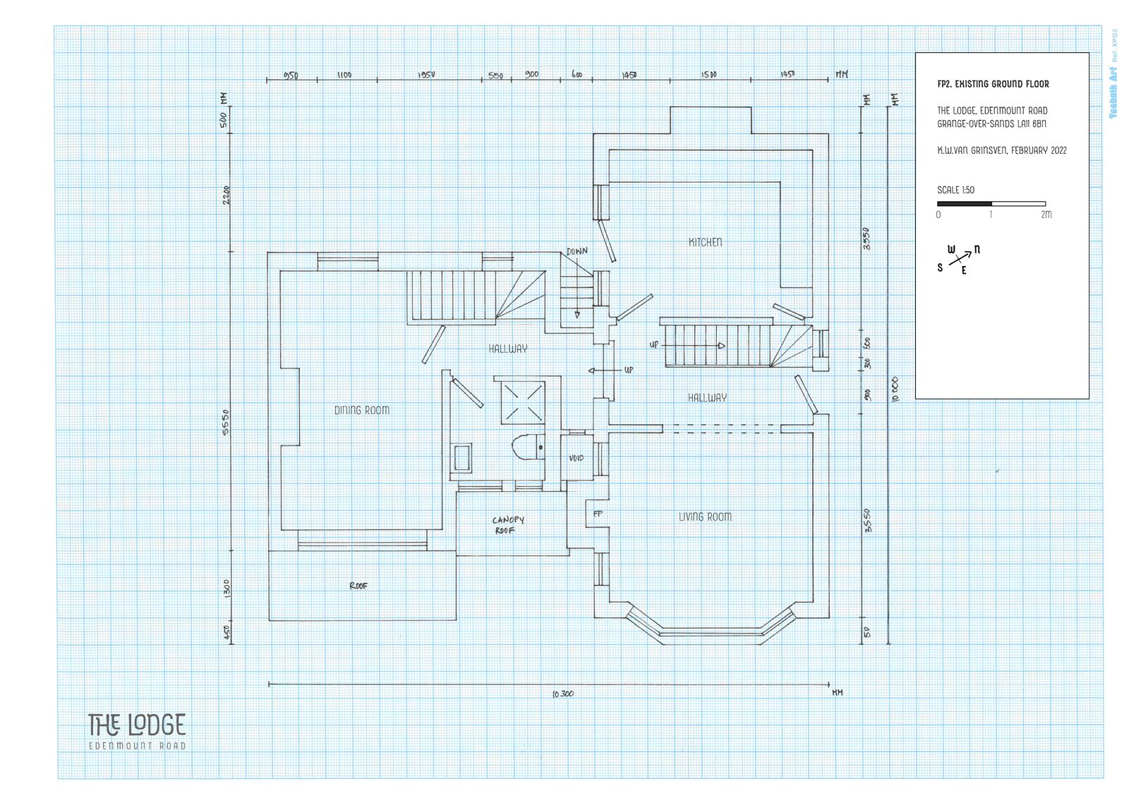

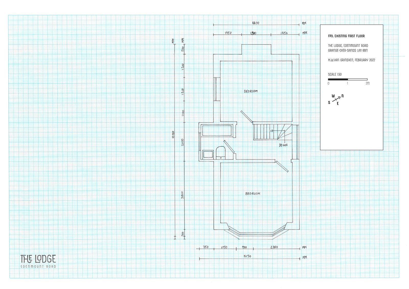

Hi thanks for your reply, I hope these plans help.
Existing ground floor plan:
Existing first floor plan:

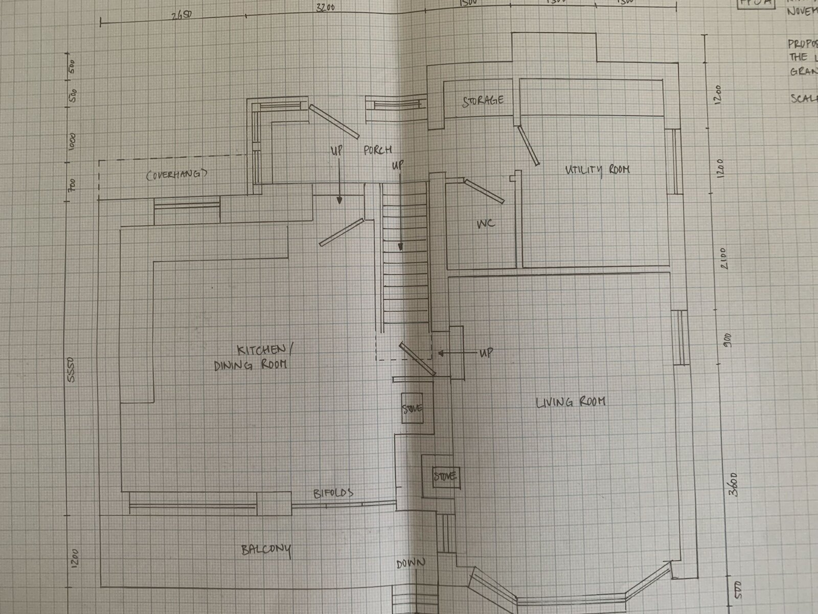

Proposed ground floor plan:

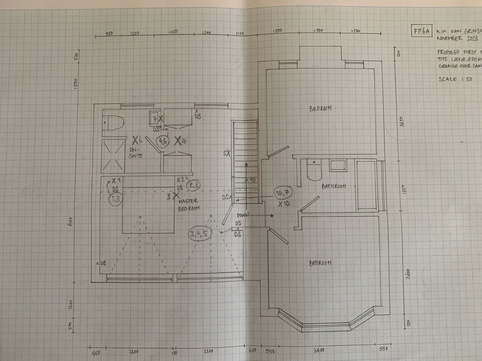

Proposed first floor plan:
Apologies for the poor quality of the last two drawings.

Isn't it because one storey is over 4.5m above ground level (the new master bedroom presumably)? So the stairway must be protected.
I assume the ground slopes away to the rear so the fire egress windows to floors above 4.5m only applies to the rear elevation?
The existing rear bedroom with the bay window is existing and you are not making the means of escape any worse so that should not be affected.
With the new master bedroom why can't you make the front window between the ensuite and stairs the fire egress window? The main entrance door is at the front so I assume the floor level to the bedroom at the front is less than 4.5m above the ground level?
Hi Wessex101, yes the 4.5 m applies only to the rear elevation. The building inspector says that it is the bay window room that causes the issue. The new master bedroom has an escape window (the one between the stairs and en-suite) which has the sloping roof from the porch right below it .

If anything you are improving the means of escape from the existing rear bedroom as the existing escape route has the stairs discharging into the ground floor hallway which is open to the living room.
If the building inspector will not budge and you want to be pragmatic it might be worth offering to fit a fire door to the kitchen and utility room on the ground floor but technically you shouldn't have to.
You are not creating an extra room on an extra storey, so the requirements for extra MoE measures do not apply. There is specific mention in B1 about this creating of extra storey.
The reference to >4.5m heights applies to new build or conversion of buildings with existing compliance to create a storey >4.5m.
As there was no existing protected escape route to an existing room and storey, then you are not under any obligation to create one ie the principle with renovation is that you should maintain compliance to the regulations in force when built and approved, but are not required to improve measures to current standards.
