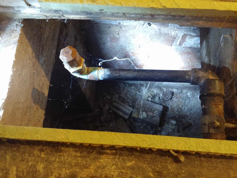

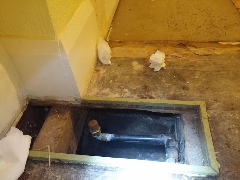

I lifted a bit of the boarding to the left of the breast where the gas pipe is and the ground is perhaps 2 to 3 ft down below, doesn't look wet and there are cob webs a spiders. There is a fair bit of air flowing through underneath however because of the venting bricks. Also the fireplace hole and the bricks around it seem dry.

I'm not sure , I suspect on the joists as the ground is at least 2ft further down. I'll try and get a picture and post it on here.

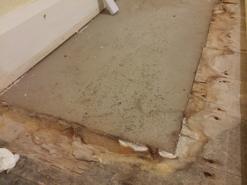

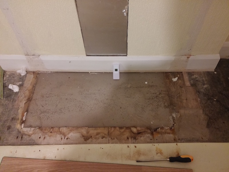

Here are some pics, you can see the staining around the edge of the concrete. If I take the covering away from the fireplace hole the bricks are dry, and looking down the hatch to the gas pipe the ground below (2ft down) looks dry, well as dry as could be expected.
The small white box is a humidity sensor which normally showing 45-52% in the room, now I have lifted the laminate and placed the sensor on the concrete base it is reading 66-68%
I should mention all floor boards look fine apart from around the concrete base.

I've just seen your latest post & pics:
The front hearth (a screed of sand and cement) looks to be newish - so some kind of work has taken place there. Perhaps to level out for the laminate (?) flooring?
There's obvious damage to the T&G boards and visible rusted nail heads.
Why not remove at least the front length of skirting (the skirting is not original) and open up the fireplace? Then post another pic?
