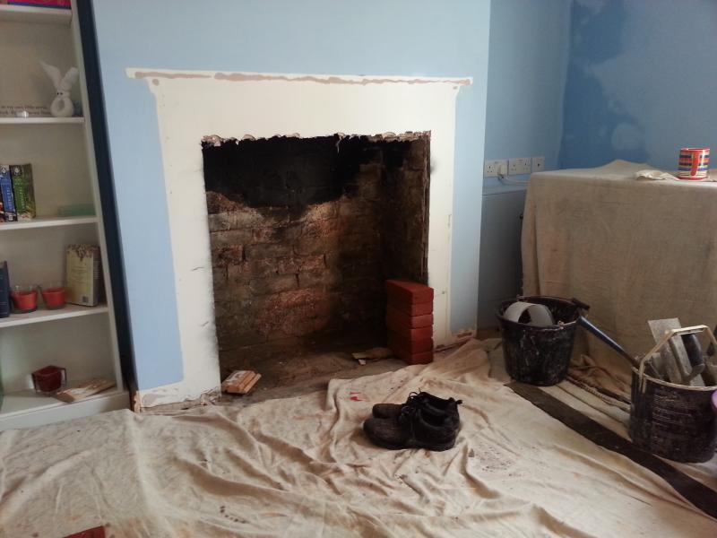

After removing the open fireplace:

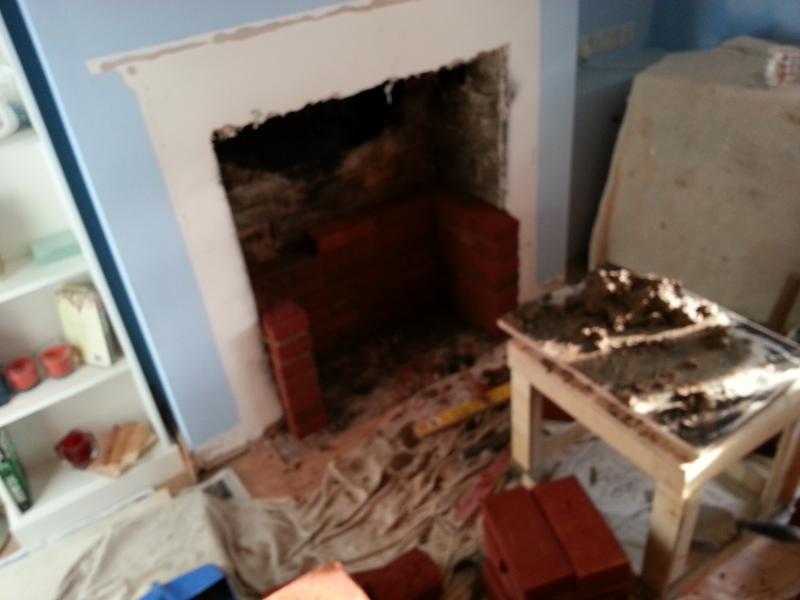

Building up the fireplace wall:

We did our fireplace 2 years ago, so far saved £500 per year in gas. I would remove all of the plaster from your chimney breast to see if you have an arch like ours, then clean, clean and clean, then repoint and seal, you also get a lot of heat from both the wood burner and the flue pipe. Your wood burner looks big and if you line the walls with fire bricks which you don't need to do, if you go back to brick, I don't think you will have the enough space for your wood burner you need 6 inches of space both sides to meet regs. Also look at reclamation yards for some 9inch quarry tiles, Mine cost £ 3 each and i think look better than buying brand new and new ones you can't get 1 3/4 thick so they could crack with the heat and weight of the wood burner. Hope my photo helps. View media item 57336 [/img]
Indeed you are correct, we have have a gap of 150mm either side of the burner to meet regs.
We've gone for 600x600 marble tiles for the base, I'll take a photo and upload

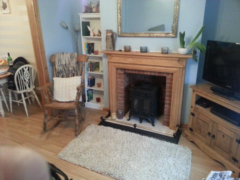

Your fireplace looks awesome, but we've decided to keep the wood surround, here's an idea of what our's looks like now:
So far so good, but:
OP, i'd suggest that you do no further work on the fireplace opening until the HETAS person has had a view.
Perhaps, read up on similar posts over the last two months?
