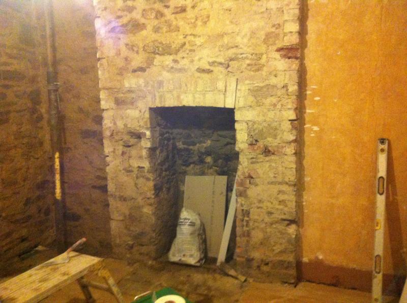

I removed some old art deco ****e, and found this quite grand old stone firèplace. It would be a shame to cover it up, so how would you go about restoring it? Seems to be mud lime stone and brick. No immediate plans to use it but a wood burner could figure later.
Thanks in advance,
Not sure what you mean by restoring it - originally there would have been an inset fire basket, a surround, probably a mantelpiece and the remainder wo0uld have been plastered.
Yes, me neither. I was thinking about raking out the old mortar and repointing it and leaving it as a feature stone wall. And leaving the breast on show with the arch. Probably woułd need to clean up the black soots or seal it somehow. I've no intention of adding a hearth surround or mantel.
So if i want to seal or paint the stone work on this breast after i clean it up, how would i go about it?
PVA sealer then masonary paint? Or should i be using some other products?

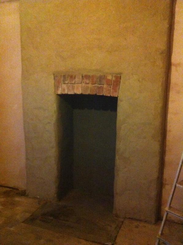

Ive decided to re render the fireplace using lime and sand, with a float finish, and point the feature arch. Will advise on outcome. Decided im going to want to fit a wood burner. Can someone please advise on what i need to do.
This is what i was planning.
Re render the inside of the inglenook up to the arch with sand cement and waterproofer, float finish.
Fit a chimney sleeve from the pot to the top of the arch.
Fit a metal plate over the woodburner and connect to the chimney sleeve. Fit Stove.
Anything else i need to do?
Cheers,
Dont do anything else until you have had the flue swept and the stack & terminal examined.
Select a stove and take the opening dimensions required for the recess.
Then call a HETAS in for a view.
Then come back here.

Ree, i think you misunderstood what ive done. I have merely rendered the front, i was fed up of looking at stone.
With regards the stove, i have not done any work on that as you have stated, though i would like to fit one later, at least now i can get the place decorated.
