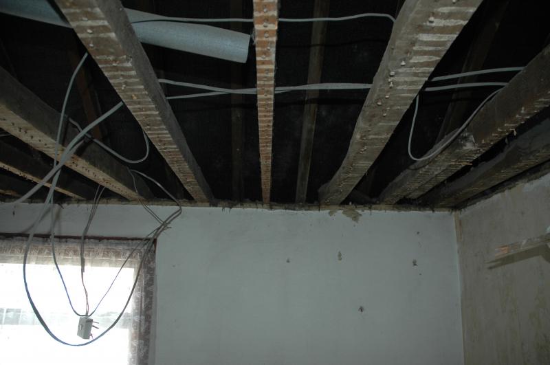

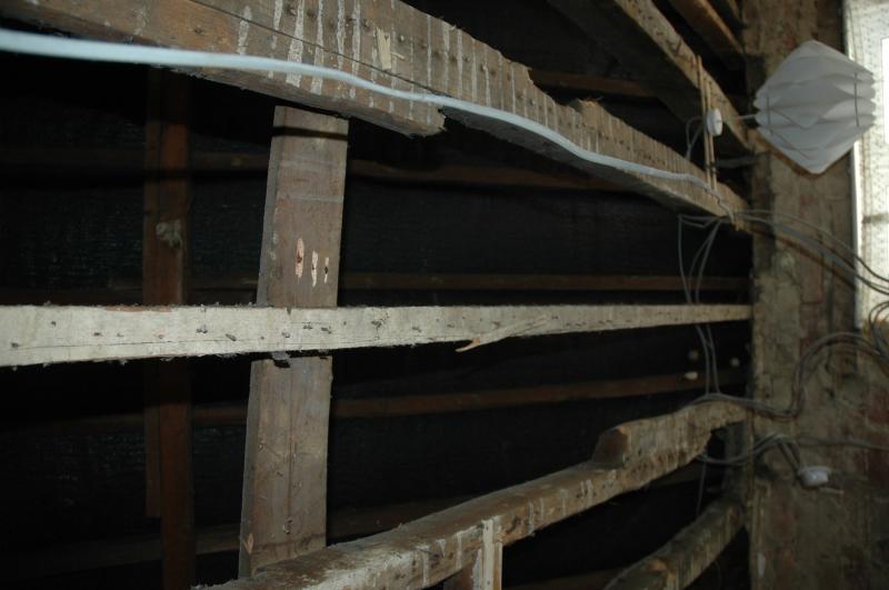

Hi All,
I am hoping for some advice. I am in the middle of renovating a Victorian terraced house and decided to remove the first floor ceilings as I thought the lath and plaster ceiling was sagging badly.
Once I had removed the lath and plaster (nice job - NOT!) it became clear that it was the joists that were sagging and not the plaster dropping.
Ideally I would like to replace these joists with new 6 x 2 timber but I am a little confused. The joists are not attached to the rafters but to the wall plates. it looks like they are nailed downwards into the wall plate. (In a modern roof the joists attach to the rafters to stop them 'pulling the walls apart' - well that was my understanding?).
The roof does have purlins front and back but whilst these take some of the weight I can't see how they stop the 'spreading' load.
My question is therefore can I (and how do I) change these for modern timber safely?
I have put some pictures up for explanation but am not sure I have got it right yet!
Lee.

Yep I did think about those options but the sag is quite pronounced (around 5" to 6" in the middle).
The sistering I don't think is an option as most of the joists aren't nice and square and therefore aren't easy to bolt through.
The other piece of advice given to me from my Dad! (which I think is what you are thinking too) was to put a beam at 90 degrees to the joists (cut into the end walls of the terrace) and then fix the joists up into it. This didn't seem a bad idea except that the underside of the joists aren't really nice and square to accept plasterboard.
I thought both of these solutions might be considered a bit of a lash? Whilst cutting in a support or sistering it seemed around the same sort of workload to just replace all the joists with new ones provided the roof didn't come in as I took them off?
Lee.

Having looked again in detail today I think I am going to have trouble fixing the new timber joists to both the wall plate and the rafters. I may be able to fix a screw through the new joist at an angle into the rafter or at worst drill a pilot hole and put a coach bolt through. The maximum span is 3.35m
I think it worth remembering that my aim here is to build a structure that can effectively support the existing joists and give me something strong enough to hang the ceiling from. I am a master of over engineering and although I want to do a proper job I also don't want to spend more time and money than is absolutely necessary.
I did think of using 5 or 6 lengths of 7"x2" at approximately 600 centres (the existing rafters are more like 400 so only every third one will line up!) and sitting these on the wall plates. (Not sure how to fix yet to stop them wanting to tip over? Noggins will help!).
Over the top of these new joists I could then fix one or two cross members at 90 degrees to the joists so that these cross members run in the direction of the purlins. These cross members could then be used as a support for the dips in the existing joists by using threaded rod, washers and nuts to bring them up. The bottom of the cross members is above the top of the existing joists and they will sit directly above where it needs supporting. (The other solution was to put the new joists near to the existing ones and simply bolt through but it seemed to me that this would put a sideways load onto the new joists which isn't efficient.
I hope I have managed to explain this clearly. 1 drawing would probably clear it all up!. What do you think?
