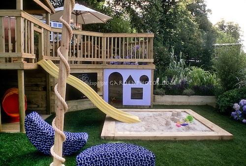

This is kinda what Im going for
Although, we had thoughts about having one side decked with barrier fencing and a slide from it.
We do need to consider steps and the ones that are there have to go, they are lethal! Too long and deep to walkdown and the children have been down head first a few times.
