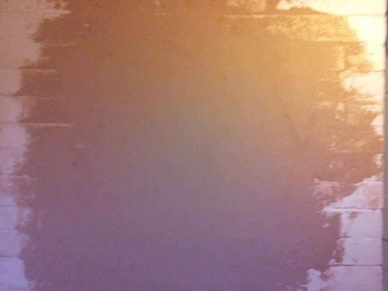

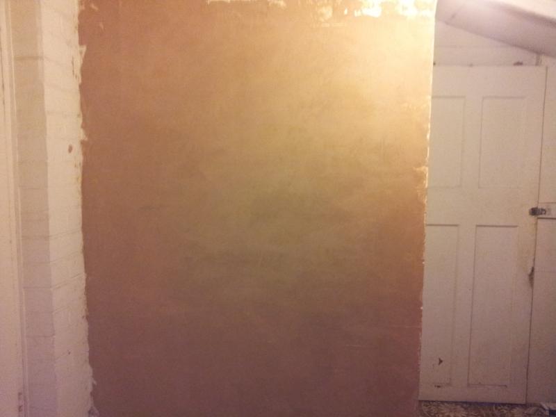

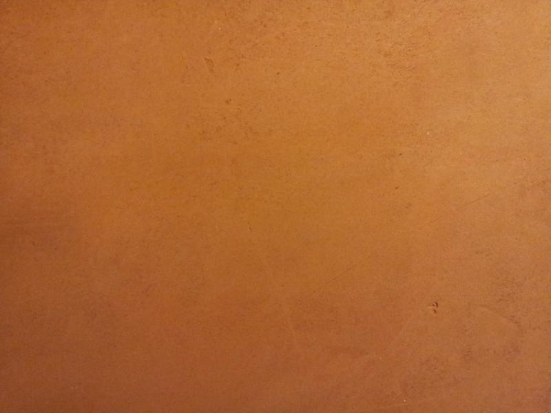

first time plastering, good fun
19 Mar 2013
8
First time plastering. To be honest im quite pleased. The hardest part was choos8ng the correct plaster. E.g browning. Bonding. Thistle. Mutli finish. Undercoat. Fin8sh etc etc
I ended up with some bonding coat and multi finish. I got british gypsom thistle stuff.
THis was a practice wall. The whole wall took me about an hour. The plaster started to set really quick. Also the guidence for mixing were pants, when i followed guidance it was far to thick. Second time after watching youtibe video i used my git inst8ncts as to consistency. It was brick wall. Didnt matter if looked rubbish. Most likely getting knocked down.
I also mixed pva into the mixture. Just small amount. Applied thin pva m8xture to wall aswell prior to applying plaster.
Opinions and feedback please.
Also a question. I ran out of plaster (hence why top isnt done) this has set. Should i add another coat? And would then be ready to paint?
All pics are same wall.[
Apologies for typos. All done on my mobile. (this sire not easiest to use on mobile)
All comments, feedback, criticism welcome ( remember complete novice)
Just in case there is any confusion the first pics is the finished wall, last pic is part way through, first pic is part way through. Had to get more plaster
:)[/u]
Well done for having a go.
It looks like you started in the middle and moved outwards.
It's more usual to start at the top and work down. Some may start at the bottom, but more usual from top.
You don't need pva in the plaster mix; you're right about applying diluted pva before plastering.
Thanks diy newbie. The thing is i wasnt going to do the whole wall bit just practice little bit so thats why i started in the middle.
The reason for all this is couple walls needs plastering in main living room. My qiestion is that if im going to put lining paper over the wall and paint the paper, do i need ot make sure the wall is really smooth or can i get away woth it if it isnt.
It still needs to be smooth - any imperfections/undulations will show up when you paper and paint. The secret is to get the undercoat layer flat, then the skim will follow nicely, in my experience. As a DIYer, I've been doing my own plastering for 30+ years, walls and ceilings. It just take plenty of practice but as in all things, the preparation (ie undercoats etc) is key to getting a good finish.

Please don't put lining paper on a nicely skimmed wall, it's bloody horrible stuff, speaking from a painters point of view if you do decide to skim yourself and there are any imperfections don't worry about it cos it can be fixed I repeat do not resort to lining paper
if its done by a good plasterer then NO need for lining paper nothing a bag of easy fill wont cover and good power sander
