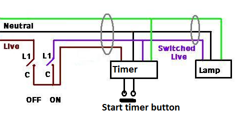

I'm intending to install some garden lights (not security lights), which I want to be controlled via a timer or photocell. However, I'd also like mount an outside switch so that, if we are in the garden and wish to switch the lights on early, we can do. I've thought about this and I'm thinking that it's as simple as treating it as a two way light switching circuit but with one of the switches being a timer/photocell and the other a simple on/off switch.
Am I correct in thinking it's that simple, or is it more complex than that?

AndyPRK - I thought about your suggestion but what I'm trying to achieve is the following. If we decide to operate the lights before the timer/photocell switched them on, at the end of the night, I'm pretty sure I will forget to switch them off again hence, I'd like the timer/photocell to take back control. Which in my mind is like a two way switching circuit i.e. the last operated switch determines the status of the light.

If it was a two circuit with the timer as one of the two switches then.... The timer goes ON and the lamp is lit. Later you switch the other switch to turn the lamp OFF. Some time later the timer period times out and goes OFF. This causes the lamp to come back ON when you don't want it to
If the timer is one that has a button to start the time period then
That can't be right.
How would you connect a two-way switch to a timer with ony one Line terminal?
Either there are two-way timer switches (and PIRs) or there are not. I don't think there are.
Chose a PIR that has a “pulse override” feature. You just need a switch in the supply line to the PIR.
All that is needed is to switch the supply off and on twice and the light will stay on until it next automatically turns off.
No extra wiring needed.
As the OP wants an over ride ON function and not a two way function then timer or what ever control the lamp "automatically" only requires to have a make contact.

Two-way function is, or was, what he wanted.
And if he did not forget and did turn them OFF then, with a simple two circuit, when the timer/photocell took back control the lights would come back on..
