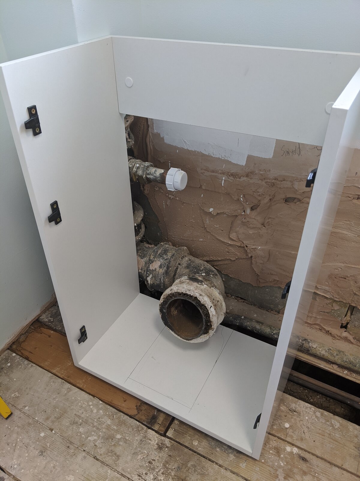

I'm fitting our bathroom which has an old cast iron waste that's obviously in the wrong place!
What's your thoughts on this?
If I cut the cabinet, the waste is almost at the front of the unit & I'm not sure there'll be enough space to fit a pan connector.
If I bring it forward slightly I'll need to buy a new worktop (currently the path of least resistance!)
Any other options?
The cabinet needs to have legs fitted which will raise it by 11cm

Cut the pipe back to collar to remove the right angle giving you plenty of room to replace with plastic .
I did think that but I don't know if I can get all round to cut it.
Recip saw with metal cutting blade or hacksaw if you have time on your hands.
