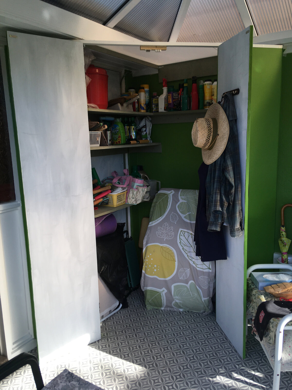

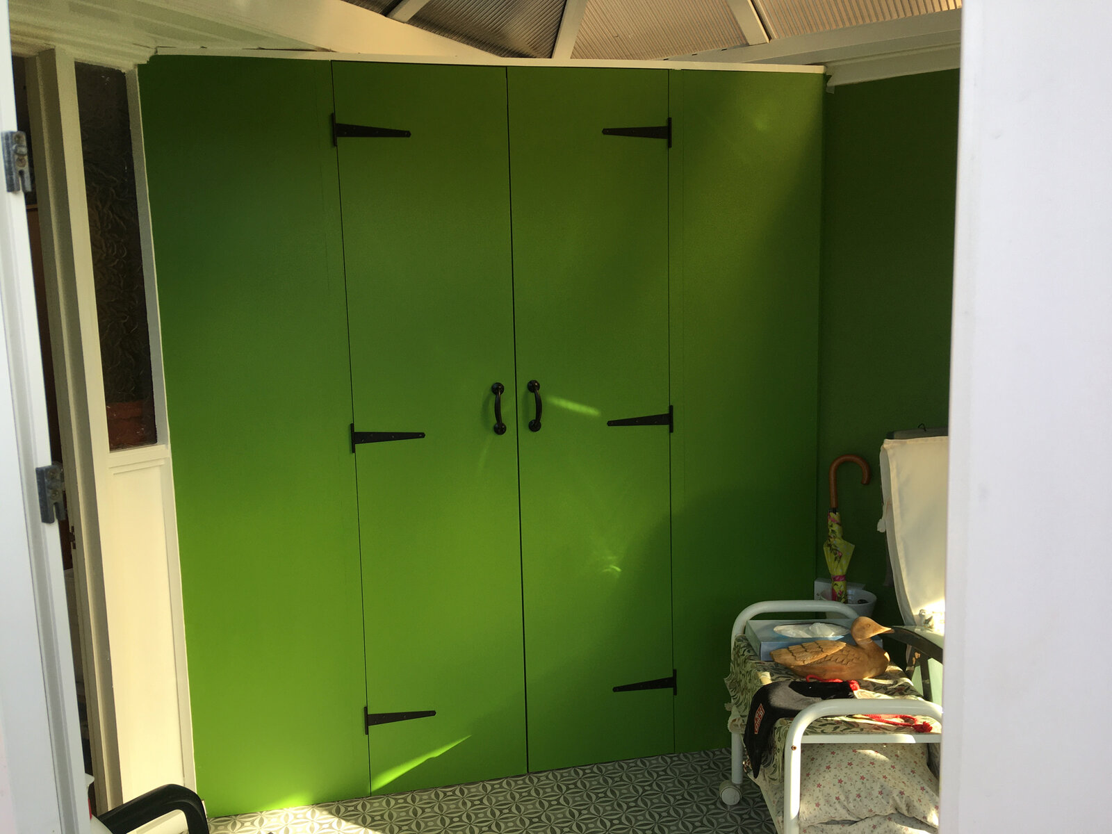

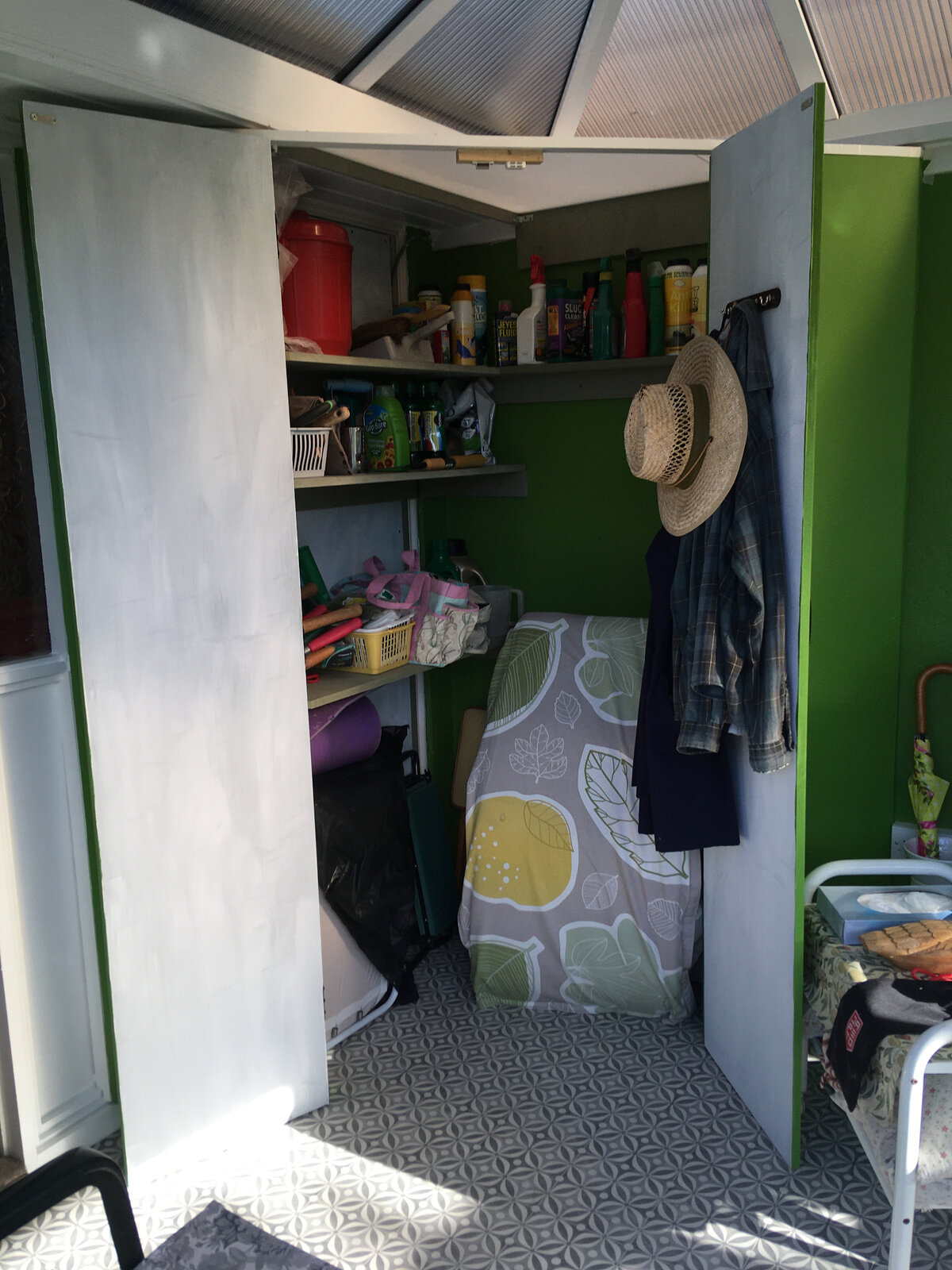

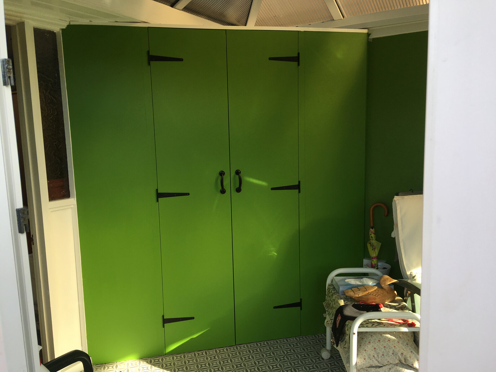

I have only recently - this year made a cupboard and doors out of MDF - corner of conservatory seems to work ok, BUT i dont think I would have made to doors out of MDF for a bedroom
