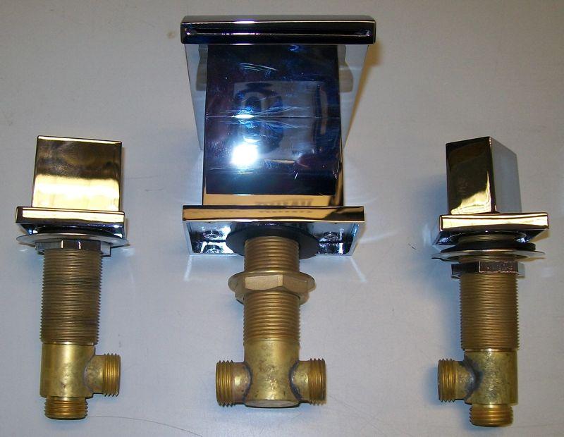

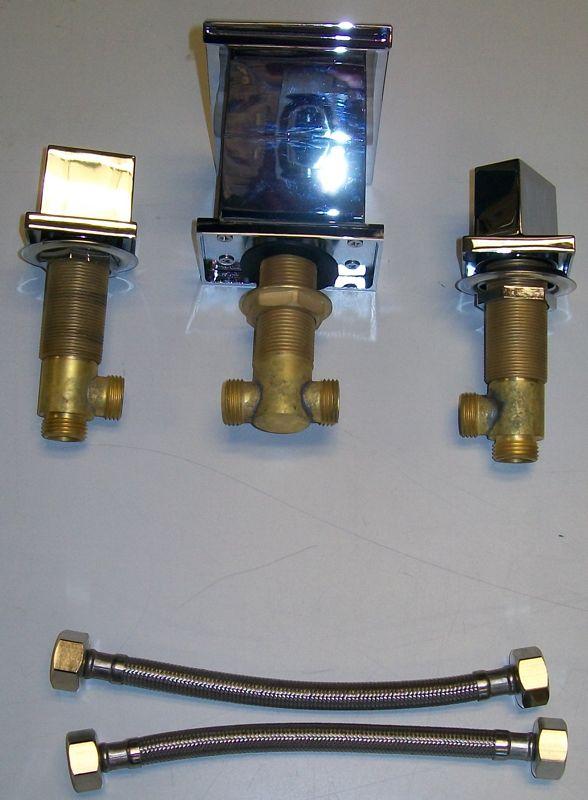

Helping a friend with some renovations, and got to the bathroom. He's having some 3-hole taps and I have a query on fitting them. This the the pack contents :
and a closer view of just the taps :
Wouldn't be my style choice, but he likes the square look.

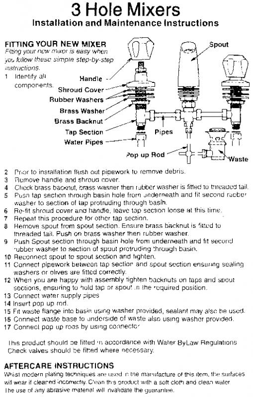

The instructions are terse to say the least :
Now, my query.
I'm thinking that the links between the taps and the spout (labelled "pipes" in the instructions) are best done with rigid pipe. Unless they are rigid, it won't be possible to unscrew the top and remove the valve insert later - as shown here, with the top unscrewed, the valve insert is accessible and I assume should be removable with a reasonable length box spanner. Guess I ought to check it will come out before they are stuck at the back of the bath. With the top off, the only thing holding the valve body in place is the link pipe - the supply pipe will be a flexible.
So I'm thinking 1/2" to 15mm copper adapters (4 off), and short pieces of copper pipe. Does that that seem reasonable ?

An absolutely ghastly design, and you'll have to get your measurements spot on for these.
I've found it best to fix the central spout first (do the backnut up real tight)
because the taps, once they are slid into their hole, have to be connected up initially with their backnuts slack - until the side pipes are connected - and then tightened as best you can.
I used plastic pipe for these - it gives that extra bit of give needed.

Trouble is these simply don't have anything that can be held from above - only a few mm of thread that the upper nut/chrome square screws onto. The only thing above the bath surface is the chrome square bit (which screws onto the valve body) and the control knob.
Access from below will be impossible to anyone that can't squeeze underneath the bath - it's a P-shaped bath and the taps will only fit in the middle of the long side against the wall.
I did suggest a nice wall-mounted tap but he's decided on these :rolleyes:

Have you checked that the horizontal fittings won't take a olive/nut ?
It looks like the horizontal connectors are the same size as the water inputs - 15mm? I'm sure they would accept the traditional compression nut and olive fitting.
No, they are all flat ended. I suppose I could carefully measure and use some galv nipples & couplings to make a rigid assembly. Leakage shouldn't be a problem since these connections aren't pressurised.

You do right to criticise it, it's pretty awful really. The body is held in place by the chrome square which screws on after the body is offered up from underneath. Once that's removed, the only things holding the body in place are the pipes.

But it has just occurred to me that the taps can be remote from the spout ...
Does 15mm pipe slide into the holes between the tap and the spout?
Would a solder tap connector screw into place, with a fibre washer (screwfix 63069)?
John :)
I'd have to check, but yes, those connectors would probably do the job nicely.
